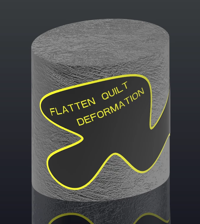

November 15, 2017
A different approach I've used for deformed labels is with the Flatten Quilt/Flatten Quilt Deformation.  Works well as long as your base surface is developable.
