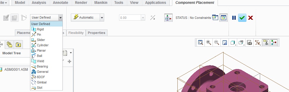

Untitled.jpgDear Users,
I am uploading a jpeg image of the common mechanim connections in creo. Please see the image. can anyone help?

But to run with servo motor mechanism fails in ball, bearing , weld connection. Why?
January 26, 2017
If this is simply showing motion, you can make a hidden connection between a rotary element and a linear element.
This will let you use a servo motor  to drive a part on a linear path.
Just make a user-defined gear connection.
