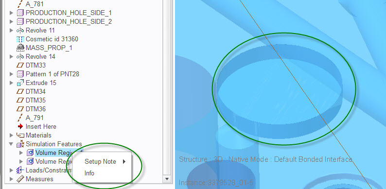

How do you delete a volume region in Creo simulate?
February 9, 2015
When I try to delete it with RMB I only get following choises (see picture) If I start a new part an create a volume region i t works perfect, but nor in this part??
February 17, 2015
Anders,
From the screenshot that you provided, this appears to be a family table instance. If this is the case, open the generic model of the family table in Creo Simulate and try to delete it from there.
