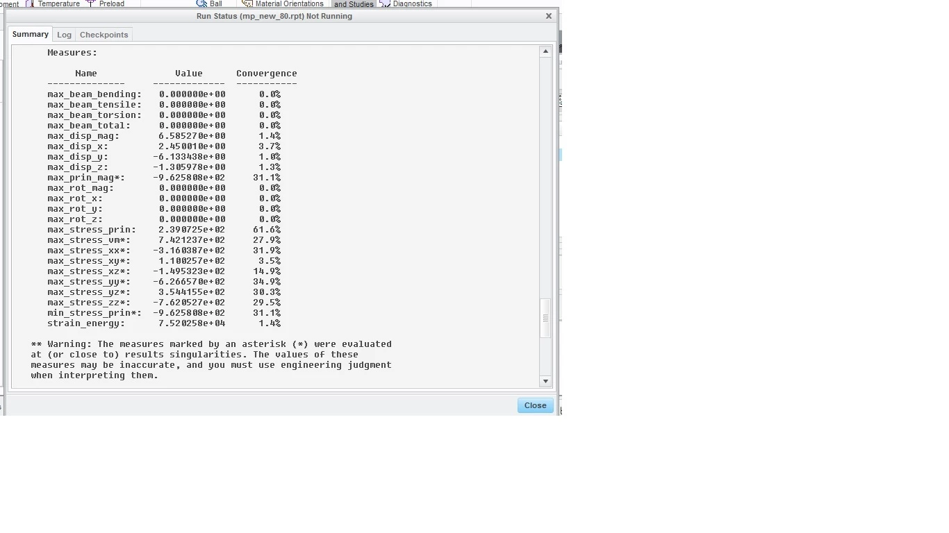

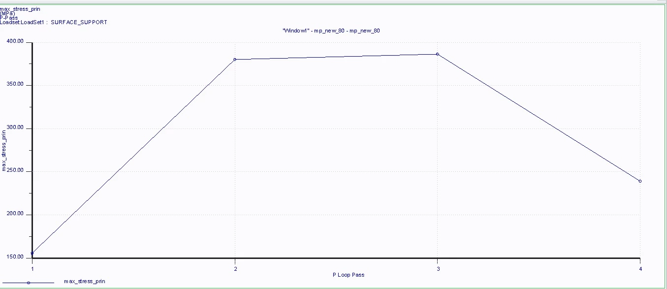

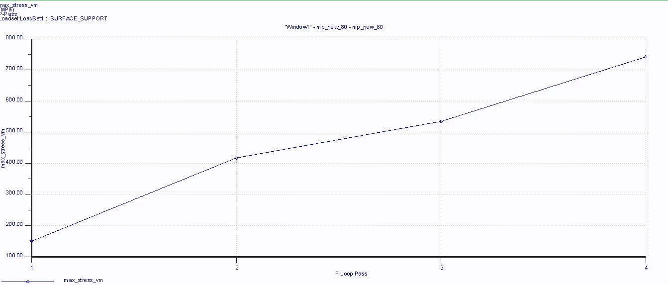

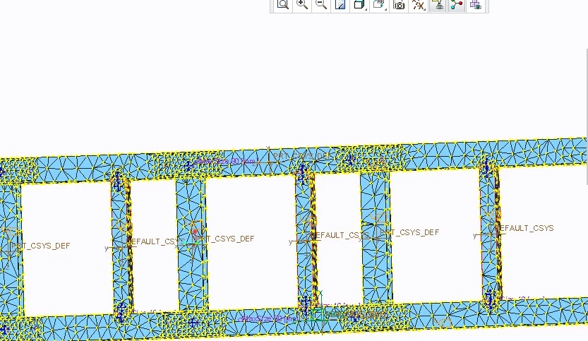

I AM  DOING A STATIC ANALYSIS OF A TRAILER CHASSIS AND WHEN OPTING FOR MULTI PASS SOLUTION THE RESULTS FOR VON MISSES AND PRINCIPAL STRESSES ARE NOT CONVERGING.
THE STATUS FILE DURING THE RUN SHOWS PRESENCE OF SINGULARITIES CAN ANYONE SUGGEST METHOD TO CONVERGE THE SOLUTUION
AND DO SUGGEST BEST CONVERGENCE RATE WHILE PERFORMING MULTI PASS, I OPTED FOR 5%

Is this a welded frame? Welds are sort of complicated to analyze, and, depending on evaluation technique, it may not be necessary to remove the singularities. According to evaluation technique of "nominal stress" (if applicable), or "hot spot method" you do not need to remove singularities, since stresses are not evaluated at those locations.

The short answer is "fillet all your sharp internal corners"!
