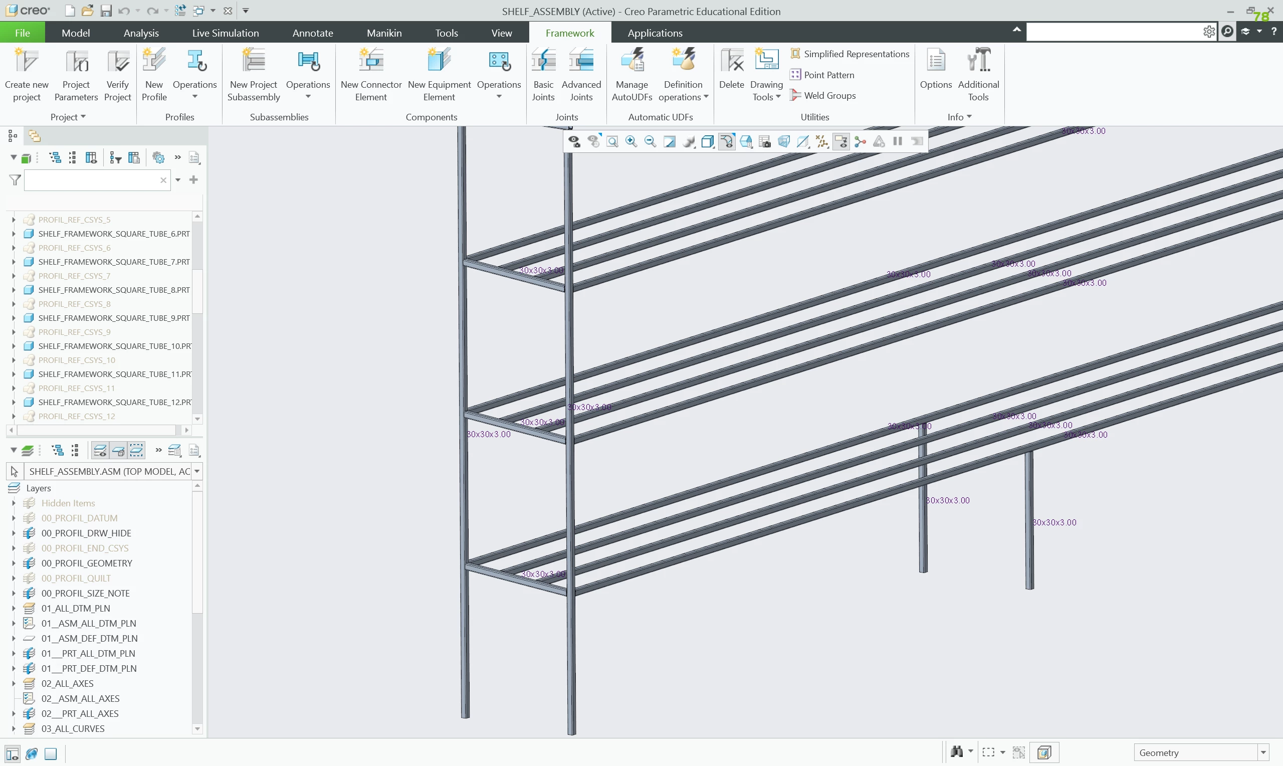

Hi everyone,
I made a shelf model from AFX features and now i want to estimate the cost of total square tubes used. All the components is made from same square tube, is there any features to quickly calculate total length of square tube used and apply custom cost per length?
