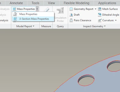

The closest things I can think of is:
1. Curve from section. My suggestion meets none of your requested criteria, export...no, xyz coordinates...no.
It does "trace" the intersection of the section plane and the part.
2. X-section mass properties, but again doesn't meet any of your requested criteria but give you the moments of inertia and cg (along with other info) of the x-section.
The thought of "coordinates of a section plane" is difficult in my imagination. Properties of the section plane is easier for me to grasp. Maybe my thoughts are helpful?!???!

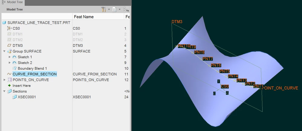

Out of the box, without additional extensions such as BMX, I'm thinking you can get your list of XYZ coordinates in this way:
1) Create the curve of interest.  It can be constructed in numerous ways, but sounds like you could simply sketch it by projecting the surface in question onto the sketch plane.  Or you can use the curve from section tool:
2) Create a pattern of datum points distributed on this curve.
3) Create a coordinate system
4) Create a view which is aligned to the coordinate system such that its Z axis points "up"
5) Create a drawing
6) Insert a general view, orient it as per (4)

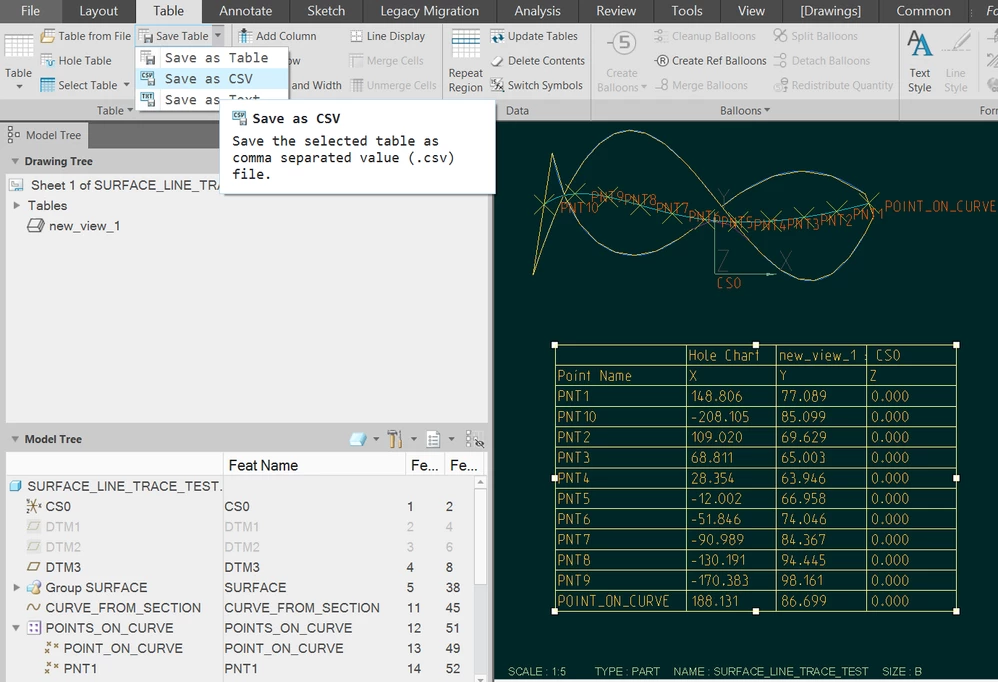

7) Insert  a hole table; use datum points not holes as the things being listed in it, and use the coordinate system from (3)
😎 Save the table as a csv file
Note the table might need sorting!  Also, it gets quite slow if your "hole" table has lot of rows.
There is probably easier way of doing this.  What about saving as DXF and extracting the "POINT" information?
