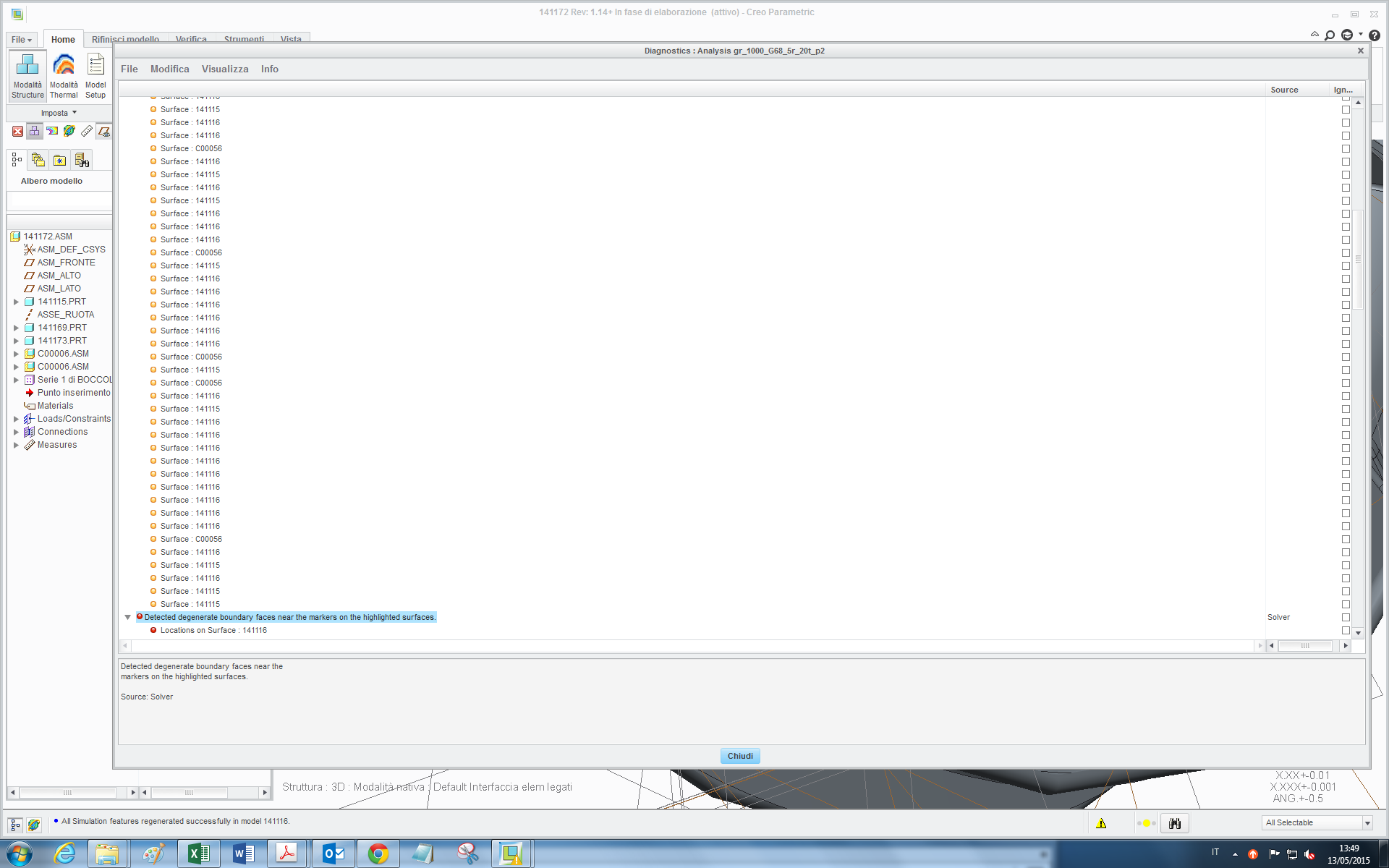

Hallo,
anyone knows what is this kind of problem and what is it due to? (here below the screenshot)
how could I fix it?
thanks

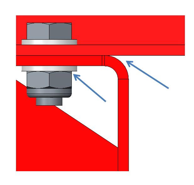

Hi Tommaso
The remark about the washer made me remember this.
i've seen issues wth degenerate surface in cases like in this picture. Surfaces that meet at a very shallow angle. If possible, make it a 90 degree angle (remove the round of the washer). Problem should be solved.
Erik
tleati12-AmethystAuthor
May 19, 2015
Hi Erik,
thanks for your suggestion, indeed could be the problem you mentioned because the surfaces ini my case could not meet perfectly at 90°.
But last days I contacted the PTC support and they suggested me to level out the precisions of the various components of the assembly, and then to lower the geometric tolerance of the Meshing --> it worked.
But maybe as you say the problem could be fixed without varying the tolance and therefore losing time in meshing up.
bye
