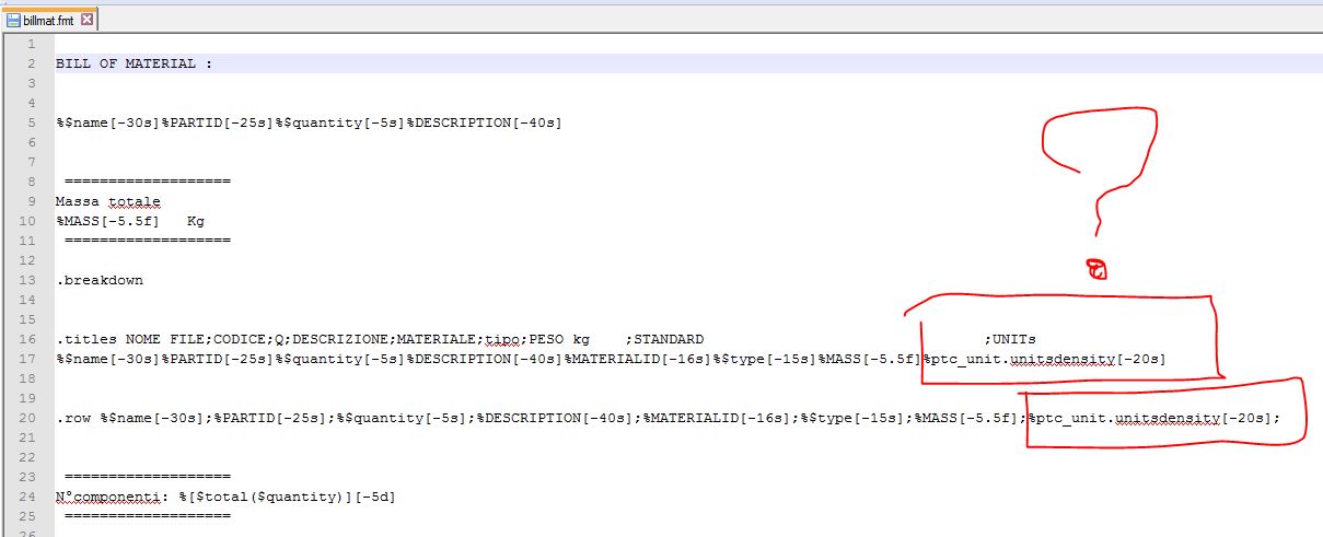

Does anybody knows extract a multi-level Unit of Measure report of a very big assembly?
I'd need to have a multi level report to check if are present parts with a unit of measure different from main assy.
It would be enough to have a report of desinty unit of measure to understand what I need.

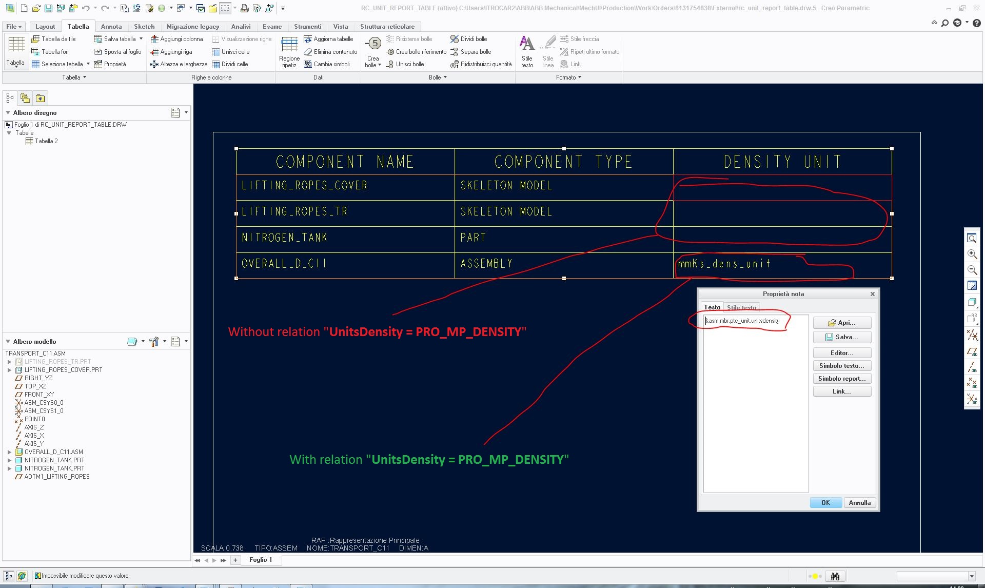

I've just tried with &asm.mbr.ptc_unit.<parameter name> in a drawing or report table (repeat region) but it doesn't work without relation UnitsDensity = PRO_MP_DENSITY in each part and I can't add this relation to 3000 components (as per https://www.ptc.com/appserver/cs/view/case_solution.jsp?n=CS126392&lang=en) . (Picture1)

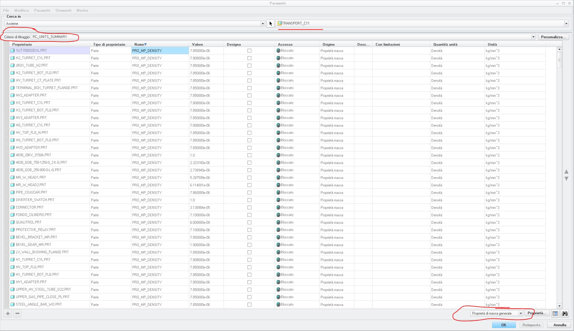

I've found a way by using parameters table (Tools > Parametrs) in "Generated Mass Props" and with a custom "Filtering settings" that shows only "PRO_MP_MASS" --> but it shows only first and second level. (Picture2)

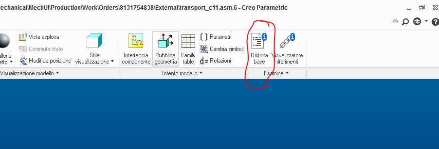

I also tried by using Bill Of Material function from CreoParametric, but I didn't find wich parameter symbol to use to query Unit of Measure or density unit of measure in billmat.fmt (Picture3-a & 3-b).
Is it possible to do this with Pro/Table or ModelCHACK, or anything else....???
