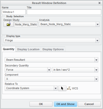

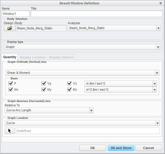

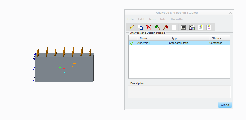

Hello all, I am new to Pro Mechanica. I have a question regarding to probe the reaction force and moment at a node of a beam element.
In my application, I use the beam element to represent my whole equipment structure. The results behave correctly. However, I have problem to know the reaction force and moment at a node connected two beams. This node actually represent the bolt joint connection in reality. Therefore, I want to know the force and moment reaction at this particular place.
Since Pro mechanica consider the beam connection is a rigid link and I can only output the reaction force and moment at the constraints. Is there any way I can find the reaction force and moment at node between beams when there is no constraint there.
Thank you all.
2-Explorer
May 19, 2014
You can do one of the two:
1. A fringe plot of force/moment:
2. A graph of the shear and moment diagram:

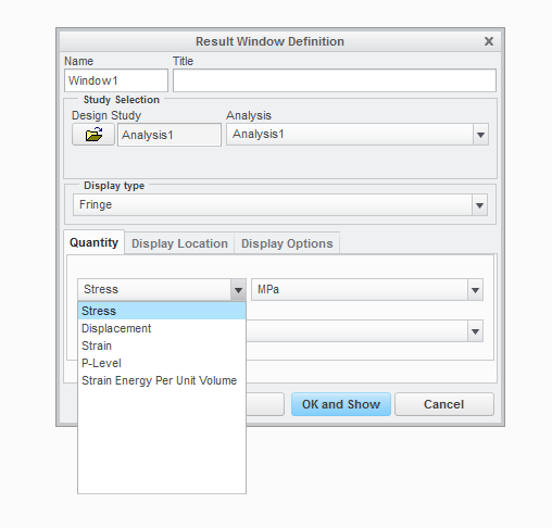

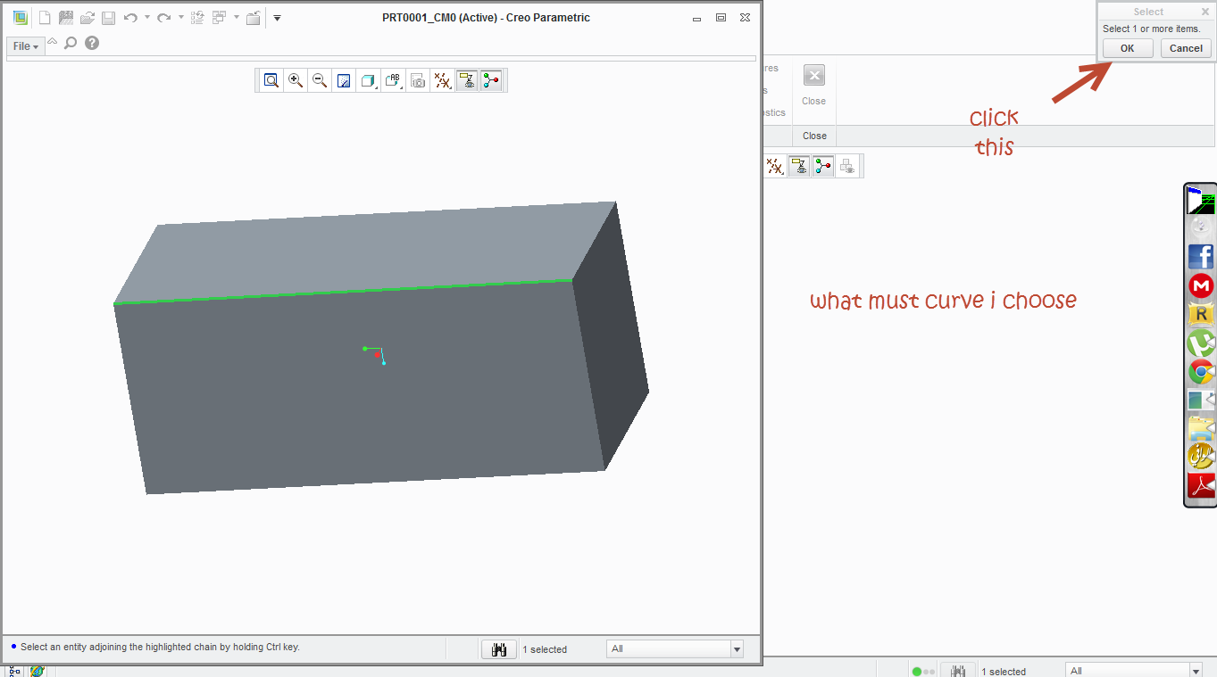

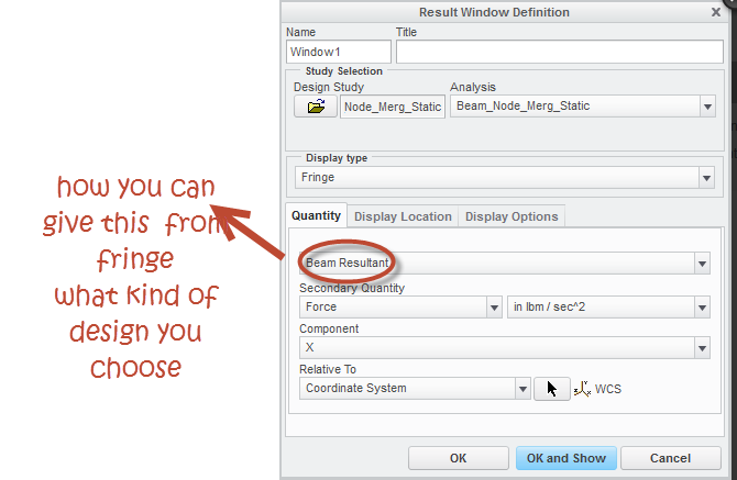

August 18, 2014
I am student and new of creo i have same problem
can give simple example

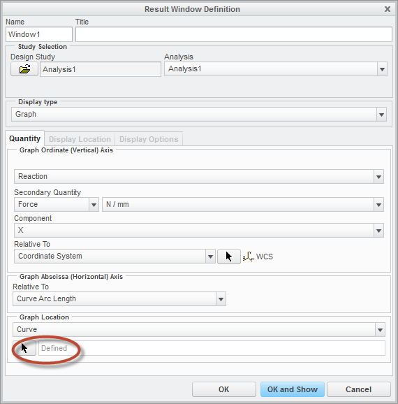

2-Explorer
August 18, 2014
Beam Resultant only works for beam elements; your model is meshed with solid elements (I'm guessing). If you want to find the recation forces at the constraint, then you'll need to define a Measure for that.
