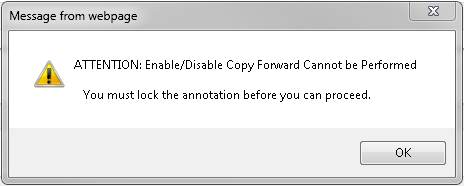

Are you locking the annotation before attempting to enable copy forward?  When I try to enable copy forward without locking first I get this error message.
I'm not completely clear on what locking an annotation does, but you can still unlock it after you enable/disable copy forward.

Yes I lock all of them because it will not allow you to enable copy forward without doing it.  All locking does is disallow others from saving over top of an edited annotation, only you can.
