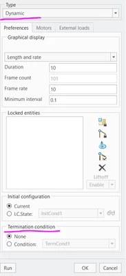

I am trying to run a Kinematic type analysis. I could not see the option to enable Termination Condition for the analysis in Kinematic type of analysis. How can I terminate the run after meeting a certain specified condition? Thanks!

Option to specify termination condition exists only in Dynamic Analysis. I am trying to specify termination condition in a Kinematic Analysis. Is there any workaround?

Hi @CSi ,
A couple more topics down in the Help Center from @VladimirN 's link confirms Termination Conditions are only valid for Dynamic Analyses.  For a Kinematic termination workaround, the definition of the analysis and use of motors, constraint limits, etc. can be considered and implemented.
Mike
