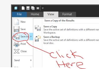

I am trying to save the animated result of a static simulation. Every website, including PTC, says to select "Movie" from the "Save As" menu. I do not see this option. How do I save/export FEA results in Creo 5?
I am using Creo 5.0.4.0 on Windows 7.

If you check the screenshot I posted, I do not have the option to save as any file type other than simulate results, hence my posting of this question. I have seen on the PTC support site that you should be able to click "Save As" and choose the file type for mpeg, but it doesn't show up.

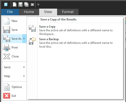

Creo is a little weird here.  Click the Save As again where I show.
Oh and correction there is a MOVIE option for AVI files.  I just never use that because it is uncompressed.

Firstly you need to run the animation, and then go to File --> Save As --> Save a Backup and then select the file type to Movie, Thats it!!! Please refer to
the video attached
