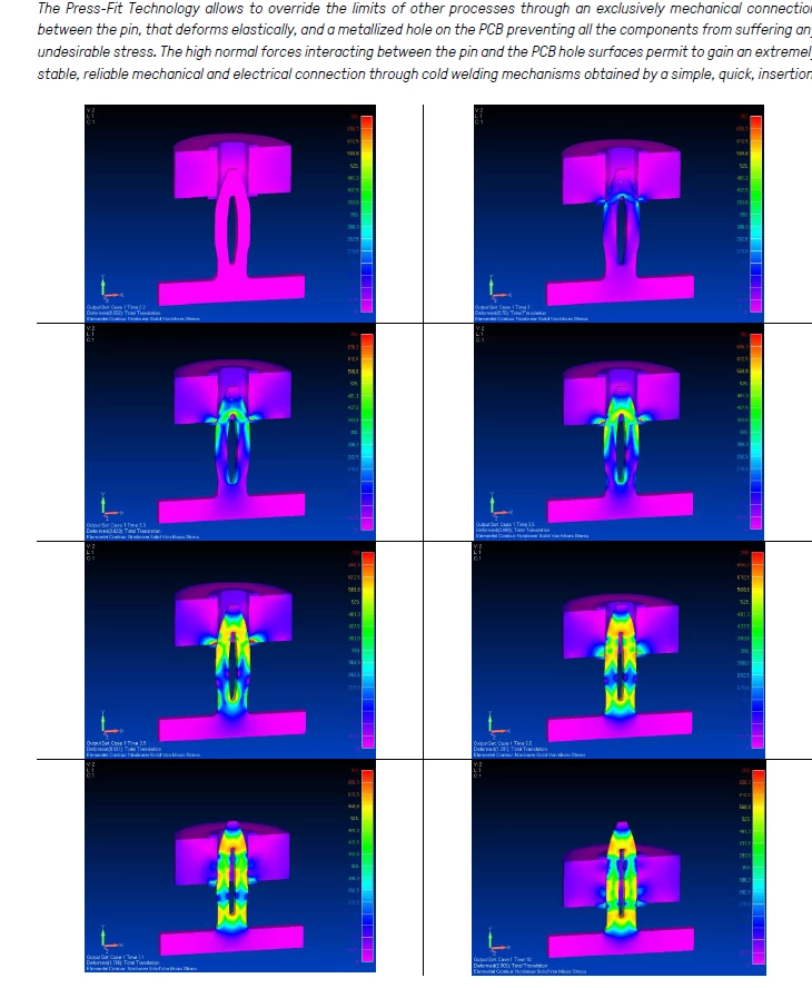

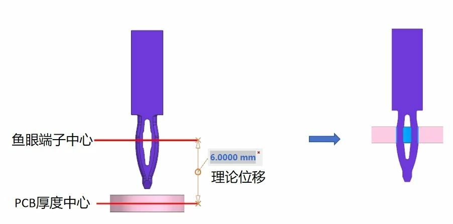

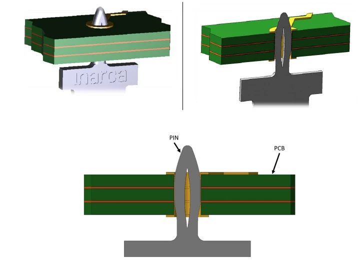

How to use Creo Ansys Simulation for embedding analysis and how much pressing force is required。
如何使用 Creo Ansys Simulation 进行嵌入分析以及需要多大的压制力
How to perform embedding analysis using Creo Ansys Simulation and how much pressing force is needed
