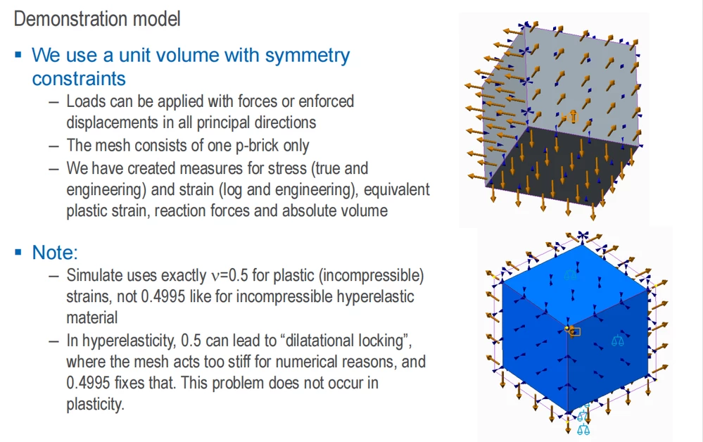

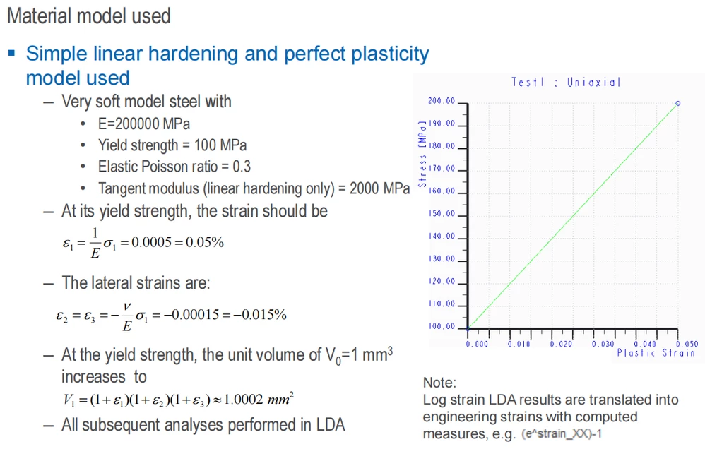

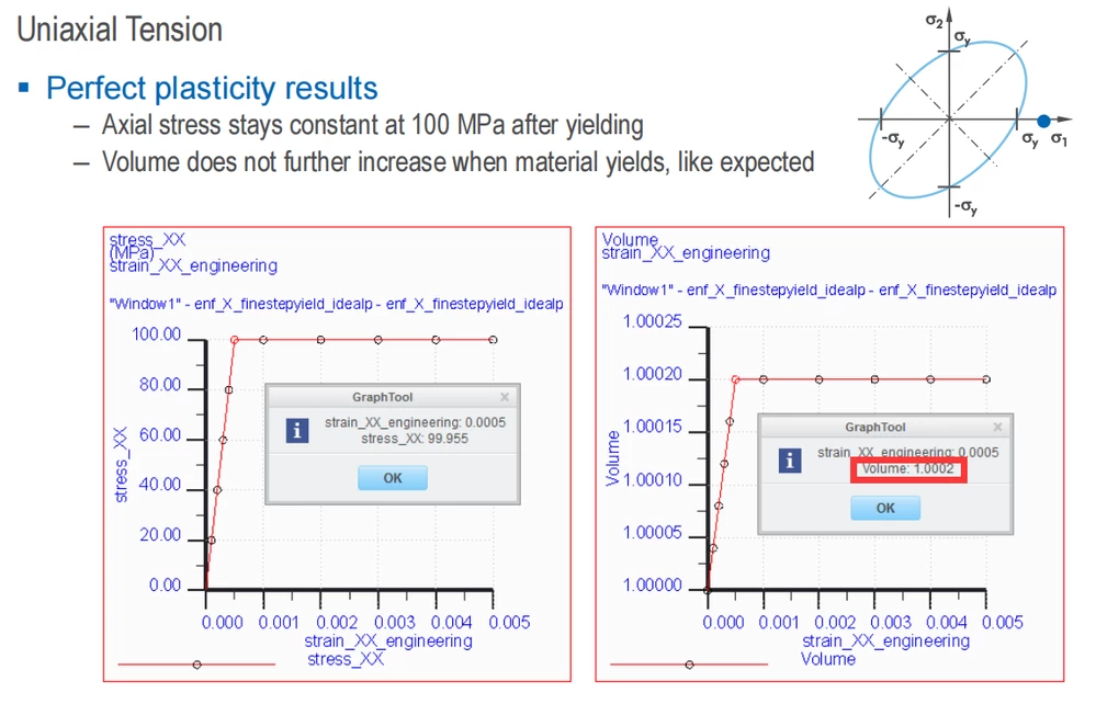

I don't know how to measure the volume of the solid part after deformation
Hello,I'm very happy to meet you here. I know you well,you can use Creo simulate smoothly. Now I have a doubt: I don't know how to measure the volume of the solid part after deformation. May you help me? Thank you first!!!1.png2.png3.png4.png
