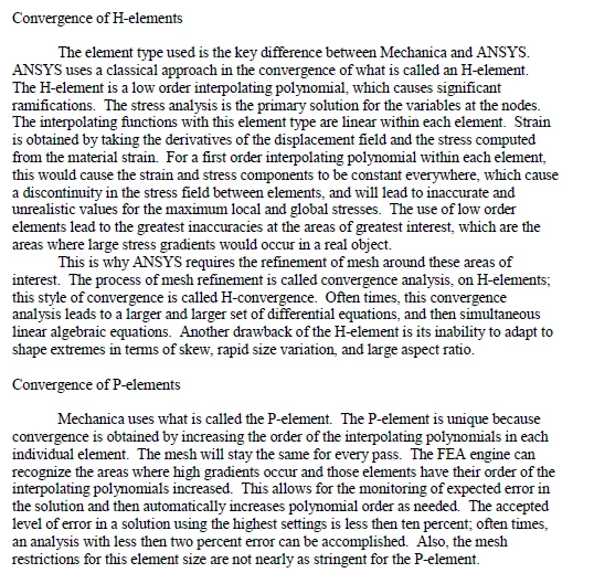

The product was formerly named Pro/Mechanica. If you search for information using this name then you may find more information. If you can find old Pro/Mechanica documentation that will probably be your best starting point. PTC used to ship voluminous sets of books with the software that was much more complete than the on line help they currently use.
A couple of links relevant to this topic:
https://www.tu-chemnitz.de/mb/MHT/SAXSIM/pdf/archiv/PTC%20Ken%20Short%20-%20Adaptivity%20methods%20in%20ProMechanica%20Structure.pdf
https://www.amazon.com/hp-Finite-Element-Methods-Applications/dp/0198503903

Here is a comparison of H/P elements (in Pro/MECHANICA and ANSYS):
