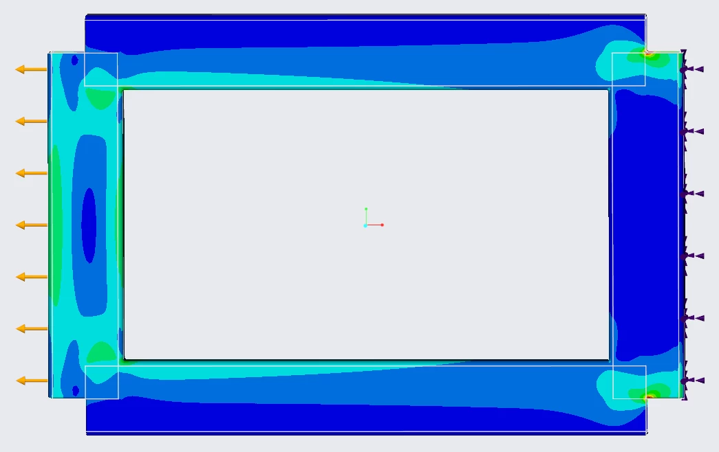

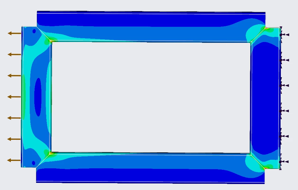

Hi everyone, I've played a bit more with it and i found out someting a bit tricky : If you let some interferences in the model, such as in the attached screenshot, you won't get any warning or failure, the calculation runs smoothly. But it looks like the system is assuming that you put twice the material in the overlapping areas. I've done the same model with adjusted profiles and the result is way different. So maybe, we should at least shoot a popup message to help identify the overlapping regions and ask for validation that those areas will be treated with the combinaison of the overlapping geometries before calculation.

Hello Todd, I've done the tests and added a third comparison model (merged components into a single one) please find the screenshots attached. We can still see the influence of the double material in both stress and displacements in the overlapping geometry area compared to the merged or adjusted models (stress or displacements franges frontiers are deformed while approeaching the overlapping area). I'm available for a webex if you need more info on this topic, Hope this helps,

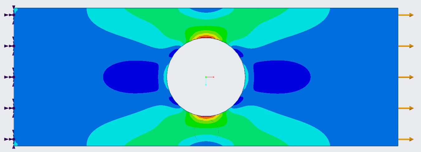

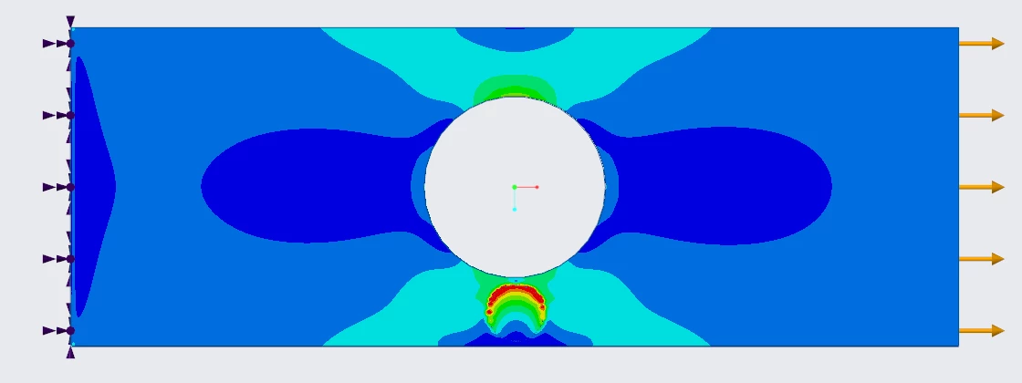

Hi again,
I've performed some more tests with a 100% interference component : main component is a plate with a hole and the second one is a small cylinder completely interfering the plate close to the hole (in the high stress area).
What i've found out is really strange : if both components have the same material, the system seems to do as if the cylinder was not existing (nothing can be seen on the area compared to the symmetrical area). But if i put different materials, then the comportment is really different and we can clearly see the stress concentration around the cylinder border.
I'm really curious to know exactly how the system is handling those cases so we can anticipate it in the model preparation.
