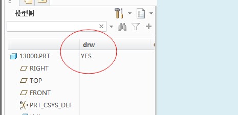

Hi!
I have thousands parts in a assembly,and I need to create drawing of the appropriate part.I have no ability to finish the works in one day.So I need a function that when I create a drawing,the appropriate part will be added a parametric record (called "drw" or other)and I will use search tool to find which part has no the parametric.so that I will know how many parts will be left over. If it possible,Please see the below picture123.jpgThanks!
September 10, 2014
If you want the value of the parameter to be updated "manually", just create a parameter of the type "Yes No" with default value "No".
Now create a mapkey to change this value to "YES", Save the mapkey.
I think you have a mapkey for creating a drawing with the same name of active model, just include the new mapkey in the beginning, using nesting technique for example.
This way each time you create a new drawing, the value or the parameter is updated.
Now, if you want Creo to check dynamically if a drawing exists for that model, I think you will need Toolkit or Jlink.
Cheers
Jose
bduncan17-PeridotAuthor
September 11, 2014
Thanks for your reply quicky."I think you have a mapkey for creating a drawing with the same name of active model,"Yes,l have used the mapkey that you provide called "new_drw.exe"http://communities.ptc.com/message/228370#228370 Now it seems I had to create the parameter manually.Thanks!
