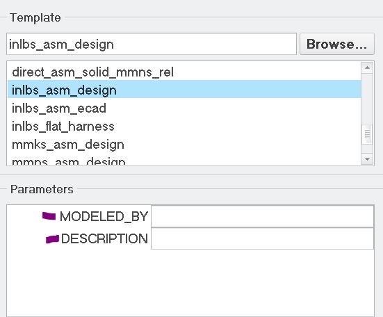

How about this. could I add more parameters to an existing template?PARAMETERS.JPG
StephenW
September 17, 2014
You can add the default relations to your start part and start assembly. Any new parts or assemblies made would have these relations.
