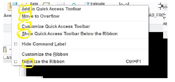

Is there anyway to get this function back?
the underlined letters in the selection options was a real time saver. Does anyone know how to get these back?
November 25, 2015
in CR3, PTC implemented new functionality which enables user to configure context menus.
See https://support.ptc.com/appserver/cs/view/solution.jsp?n=CS180863
Probable side efect of this new functionality is removing underlined letters in context menus (this is my opinion, only).
MH

November 24, 2015
  • click right mouse button
  • press ALT key
MH
SYNDAKIT15-MoonstoneAuthor
November 24, 2015
I can't get that to work in drawings. sorry I should have been more specific.
for some reason it still shows up in places like the tool bar and the navigation tab, but not in the drawing window
November 24, 2015
You can see the menu displayed on your picture only in case that mouse cursor is located on Ribbon.
MH

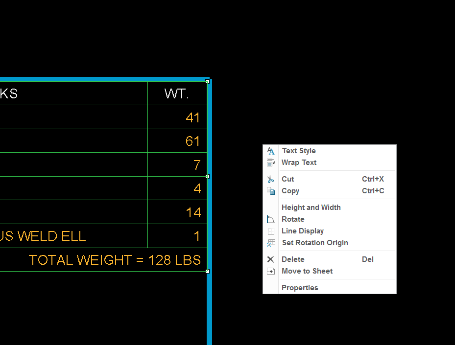

November 24, 2015
this is a better picture. in previous versions of creo some of the commands would have an underlined letter that you could just tap and it would choose it.
November 24, 2015
in CR2 M070 when I select a table and press right mouse button, I can see the following menu - some commands contain underlined letter, others not. It looks like this is current Creo behaviour.
MH
November 24, 2015
it seems that it didn't get carried over to creo 3
but could I add it somehow?
