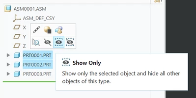

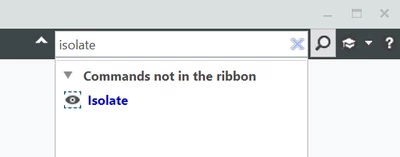

Hi @creuz and @doneill
Creo command search can translate solidworks commands to Creo.  So just type in "Isolate" and the Creo command is shown.  Layers and simplified reps are useful but not as simple as "show-only" which is a "one-click" just like many other software.
Show OnlyShow Only

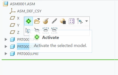

I think everyone overlooked this simple answer because these show/hide "eyeball" icons are universal to many software.  Just in case... another basic function is to activate the part you want to work on.
ActivateActivate
ActivatedActivated
