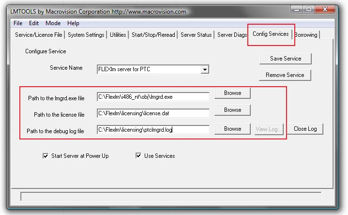

Hello!
Run the file "ptcstatus.bat" from the folder "C:\Flexlm\bin". Check the debug log file "ptclmgrd.log" (this log is intended for debug purposes only), which is located in the folder: "C:\Flexlm\licensing". If you have an active (paid) maintenance, then try to create a new "Case" with a description of the problem here: http://www.ptc.com/appserver/cs/case/case_logger.jsp

January 12, 2012
John O\'Brien wrote:
...as for the log, I can not find the file anywhere...
Look at "Config Services" tab. What path there are specified (if necessary, specify the path to the log file/create an empty text file for the log [with ".log" file extension])?
