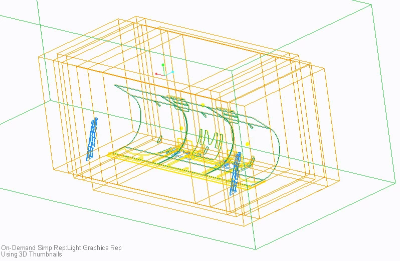

To test LWG, I opened an assembly. Saved it and then erased from memory. Now I open it and select the LWG option. I basically get a bunch of boxes that represent a componet which is difficult to use.
I attached a screen shot to show what the results are.
In the webinar, the assembly opened in a low resolution version of the models to quickly open the assembly and then you can choose what components you want to open as a master rep to do some work. I am not getting the same results as the webinar showed and I wanted to know if I am doing something wrong.
I assume you must open the assembly at least once and save for the LWG to be generated, but do I need to do this will all components, assemblies, and sub-assemblies?
Any help with this will be apprcieated. (Please look at the attached file)

What they don't tell you in the demo is that the assembly has already been a save in the CreoView format (.pvs) in the folder where the files exist. I have not tested with search paths so I don't know how well that works. I gave up on this since we work with PDMLink 9.1 for now. So I imagine that you would have to save out the .pvs for all changes that occur since the .pvs is a snapshot in time.

I thnk my problem is the <path> to the receipt file for the .pvs creation.
I honsetly don't know were to point this and it's currently pointing to <drive>:\Creo 2.0\Common Files\M010\text\prodview\export_LWG.rcp
Has anyone made this work without Windchill?
