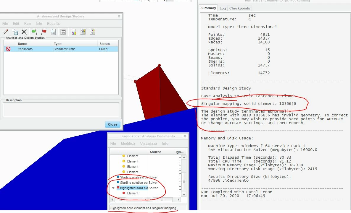

Mapping
can you help me with this problem?
It's the first time I see it
Thank you

It can be multiple reasons... the model is not fully constrained, or the geometry can't mesh properly.
Tell us a little more details ... what creo version you use, general understanding of the model, constraints, loads, etc...
I had similar issues with cast models.
Feb 8, 2021 1:36 PM UTC
check element 1036656 as it is "corrupted" invalid geometry. The meshing step didn't work and the element may well be too distorted. Might be nothing do to with a modelled not being fully constrained !
