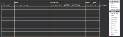

Since Creo is building solid models, they all have a mass. When you apply a material with a density to that mass, you get a weight. The software will add the weights of your assembly components and give you an assembly weight.
Apr 25, 2024 12:51 PM UTC

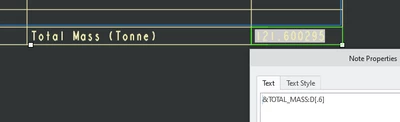

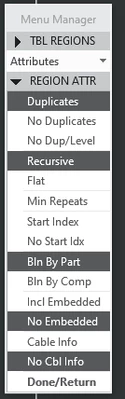

Parts do not need to be solid to have mass, they can also have ASSIGNED mass such as for example bulk items like grease. Since it is simple addition, I am reading in between the lines that there is something about the mass reported that does not seem correct and you want to investigate. I would look into making a drawing with a repeat region reporting the mass and material for the assembly. I do not remember if Creo7 has options for the repeat region to recursively expand all subassemblies but up-to-date Creo can. These screenshots should get you on your way to making a drawing table for this. It is generic so be sure to save the table for later use so it can be used as "table from file". The exact keywords changed recently so you may need to look up the correct key words for the repeat region. Once you have this table it is much quicker to identify incorrect masses and it can be saved to Excel.  (At least in Creo 11)
Chris3
Apr 25, 2024 1:41 PM UTC
@SweetPeasHub 's solution only works if the mass property parameter is being updated. Depending on your config settings it may not be. You can get a full report (although the formatting leaves a lot to be desired) if you run Analysis -> Mass Properties or file-> Prepare -> Model Properties -> Mass Properties -> Change -> generate report
with the config
mp_calc_level all_models
Alternatively you can make sure
mass_property_calculate automatic
is turned on, regen and then run the repeat region like @SweetPeasHub mentioned above.
