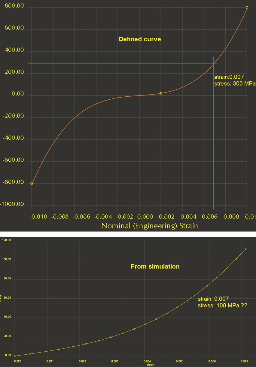

I am using a hyperelastic material model. To check the simulation, I defined a monitor point to see the stress in the function of strain. I think, the defined matarial curve and the stress-strain curve from monitor point should be same. But the result shows quite interesting curve:
The curve from result gives lower stress value compared to the defined material model.
What is the reason?
