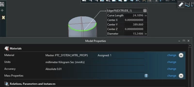

Hello.
I am using Creo Parametric 8.0.0.0.
So... the title is descriptive enough. But let me give you some extra detail. So I have metric system on my file. The measure tool uses imperial system. It will show the correct value, (for example if I set something to be 10cm it will show 3.937inch) but the file is not on inch.
I went to:
File>Prepare>Model Properties
Model is indeed in metric system. Yesterday everything was fine.
Any ideas? Thanks in advance.

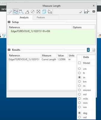

Hello
You can change the units in the measure section regardless of units the part was designed
Please try this option

Had already tried creating new file. Old files and/or imported sketches with metric system, again, are being measured in inches in new parts with metric system.

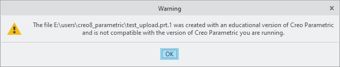

May 19, 2023 9:09 AM UTC
I am sorry I cannot open your model because of this
May 19, 2023 11:10 AM UTC
Hello
Regards
Pushkar Khanna
May 19, 2023 11:18 AM UTC
