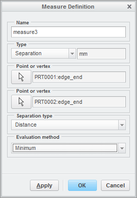

Hi all,
I have a query regarding mechanism.
Is there any way to calculate minimum distance in moving parts?
Sandeep K
Best answer by 346gnu
Sandeep,
There is a separation measure for which the evaluation measure can be 'minimum'.
Vertices are required
Although using it effectively may not be as straight forward as first appears.
Often one has to use the centres of circular bodies as one of the references.
The approach to a flat surface becomes problematic. You don't know where along the surface the minimum distance will occur. We end up making a 'dummy body' on slider that tracks the approaching body.
The technique required depends much on context.
Regards
