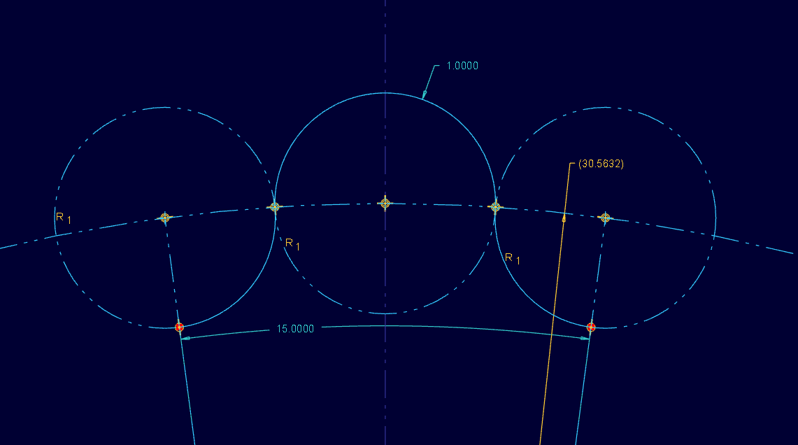

I made a spur gear setup that has a high number of digits when you work out the pitch circle ratios.
When you check the properties of the mechanism session, the ratio is truncated to only 5 digits.
This causes a mismatch pretty quickly in a simulation. I have tried every way possible to define these including generic gears with user defined connections. User defined input will take a relation value with the high number of digits but the output doesn't change. It still calculated with 5 digits.
Anyone else run into this, and have any of you reported this? Is there a solution with some sort of precision setting?

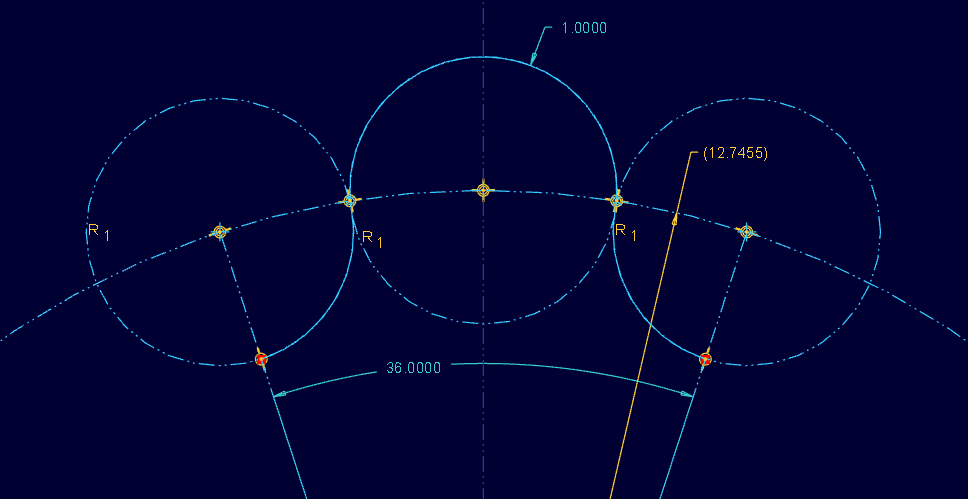

So I figured out my 1st problem due to an assumption... the ratio is obviously 2.4 even. ...10T and 24T mesh.
I had finally figured out exactly how to make these gears (actually 2 ways) but the question still remains... what if I have a very odd ratio (belt drive or friction gears)... does the software consider the Nth digit or is it truncated at 5. I have posed the question to the Support people.
If anyone is interested in this gear-style, let me know and I'll post a document.
Here is the video. After changing the ratio's to the actual diameters (DIAM1 and DIAM2), I re-run the analysis yielding the same results. Notice that the gear dialog does maintain a lot more digits than the information dialog reflects.
These are the gear definitions: Each has the same diameter "teeth" and the pitch diameter is determined by the angle. These should be "perfectly meshed" gear sets where nice round ratios are rarely achieved (re: 1:1)
