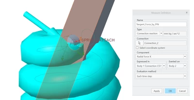

Best answer by SweetPeasHub
Its just a very annoying bug with a simple work around.
Do not copy the measure from another measure.  Do not edit the measure with additional variables after apply/OK the first time.
In one step create a user measure from scratch with Spring_load*X_coorddp/Spring_length.
This should work, let me know if it doesn't for you.
Why?  I think there are data type issues not properly allocating space for the data series when the types change due to an edit.  Something is missing in the definition that does not pass into the CAD side.
As a note, there are two other ways to measure the force you are wanting.
1. net load on the servo motor getting torque.  Then a measure to divide by 60mm.  (or you can use a separation measure to get the 60mm distance but watch this bug turning up again if you edit/change the 60 constant to the separation measure. (create a whole new measure instead)
2. add a dummy pin part where the spring connects.  Get the connection reaction for the pin joint referenced to the moving arm. I prefer this because it is more directly obtaining what you want and will not have the bug that user defined measures can have.

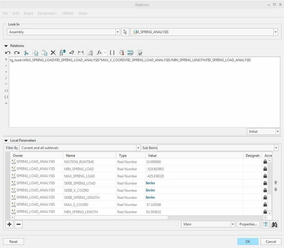

May 13, 2019
I've done some test and I'm not be able to utilize the "tangent_load" for optimization/feasibility study.
Even by specifying a relation with data taken from motion analysis
  • max_sping_load
  • max_x_coord
  • min_spring_length
I can't utilize it for the optimization.
It appears you can use only dimensions/parameters/measures directly created by Creo
