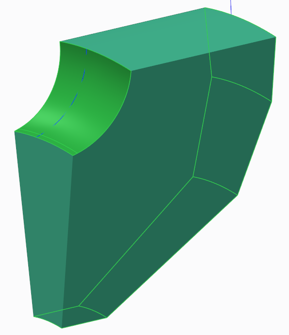

Is there in CREO 2.0 a function similar to "midsurface by face pairs" that can be found in NX? I used to use it a lot for the design of hydraulic turbines blades...

In Creo Parametric, this is done with relations. You have several ways to get there including a saved measurement, or to use a feature's value and performing an operation on it (in this case, divide by 2).
October 29, 2013
Thank you for your answer Antonius, but...do you have an example???
How would you proceed with the two sets of surfaces highlighted?
October 29, 2013
Can you sketch the approximate solution of what you are thinking the result is? I am not certain of the solution you seek here.
