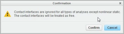

Within Creo Simulate are contact features supported in a Modal analysis?
If they are, how do you enable them in a Modal Analysis?
If not, does any one know if an enhancement request has been created and where to find it?
No support for Modal and Contacts analysis?No support for Modal and Contacts analysis?

There is no contact supported for modal.
Modal is a linear solver.
When contact is involved then strictly speaking there are no natural frequencies and solvers get more complicated.
If, for example, there is a bolted connection then the stiffness of the connection should be modelled.

penalty contact is nonlinear, Modal Analysis is linear.
alternative to nonlinear contact: Fastener
