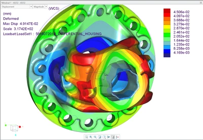

Hello all,
I want to construct a differential system which is supported by two tapered roller bearing on both the sides.
As we all know that in tapered roller bearing the forces are distributed in axial and radial direction depending upon the angle of the taper.
Is there any possibility of creating a parameter which would represent as tapered roller bearing in the system and transfer the forces further in the gearbox housing accordingly.
I am attaching a basic image which would give you the idea of forces and constraints but the transfer of force is through a bearing where the forces further applied on the housing linearly without any effect of taper roller bearing and this is creating some unwanted results which does not represent any comparable stresses and displacement done in the Real static  torsion test on the model.New Doc 2019-07-16 12.04.45_1.jpg

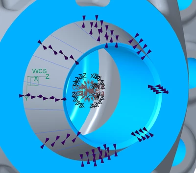

Sorry, I think the question is not clear.  Also, getting correlation to a real test on this assembly might be beyond what the community can assist with.  The details and time involved will be extensive and complex.  There are many questions to pursue.
A more specific question might be "How to model a taper bearing constraint?"
Creo is challenged with a taper bearing constraint because it is not a nodal based method, whereas many other FEA programs are nodal based.  My first approach might be to model not as a constraint but as a non-uniform load using an equation so the force vector is normal to the taper.  (free body method with possible inertia relief) As a second approach, If I really needed to model the taper using displacement constraints instead of loads, I would do as follows.
Separate the bearing surface into many smaller surface regions with coordinate systems for each surface region pointing in the correct direction for constraining that local surface.  This is essentially similar to how it would be done in a nodal based FEA system, where each node would have its own unique local coordinate system to define the direction for its displacement constraint.   The main difference is in Creo, for a 3D model, surfaces need to be used because a point constraint makes a singularity.
Note that there needs to be a band of unconstrained surface between each region, otherwise it will be over-constrained at the shared edge.  In my quick example the unconstrained bands are the same size as the constrained ones, but this should be adjusted.Piece-wise taper bearing constraintPiece-wise taper bearing constraint

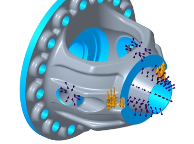

In order to test that the bearing is free in rotation I performed a simulation with torque applied as this image shows.Taper bearing test modelTaper bearing test model
As you can see in the next image, the bearing surfaces can rotate with a torque applied, however they are distorted.  This can be improved by dividing into more regions and reducing the size of the unconstrained areas between regions.
taper bearing resulttaper bearing result
