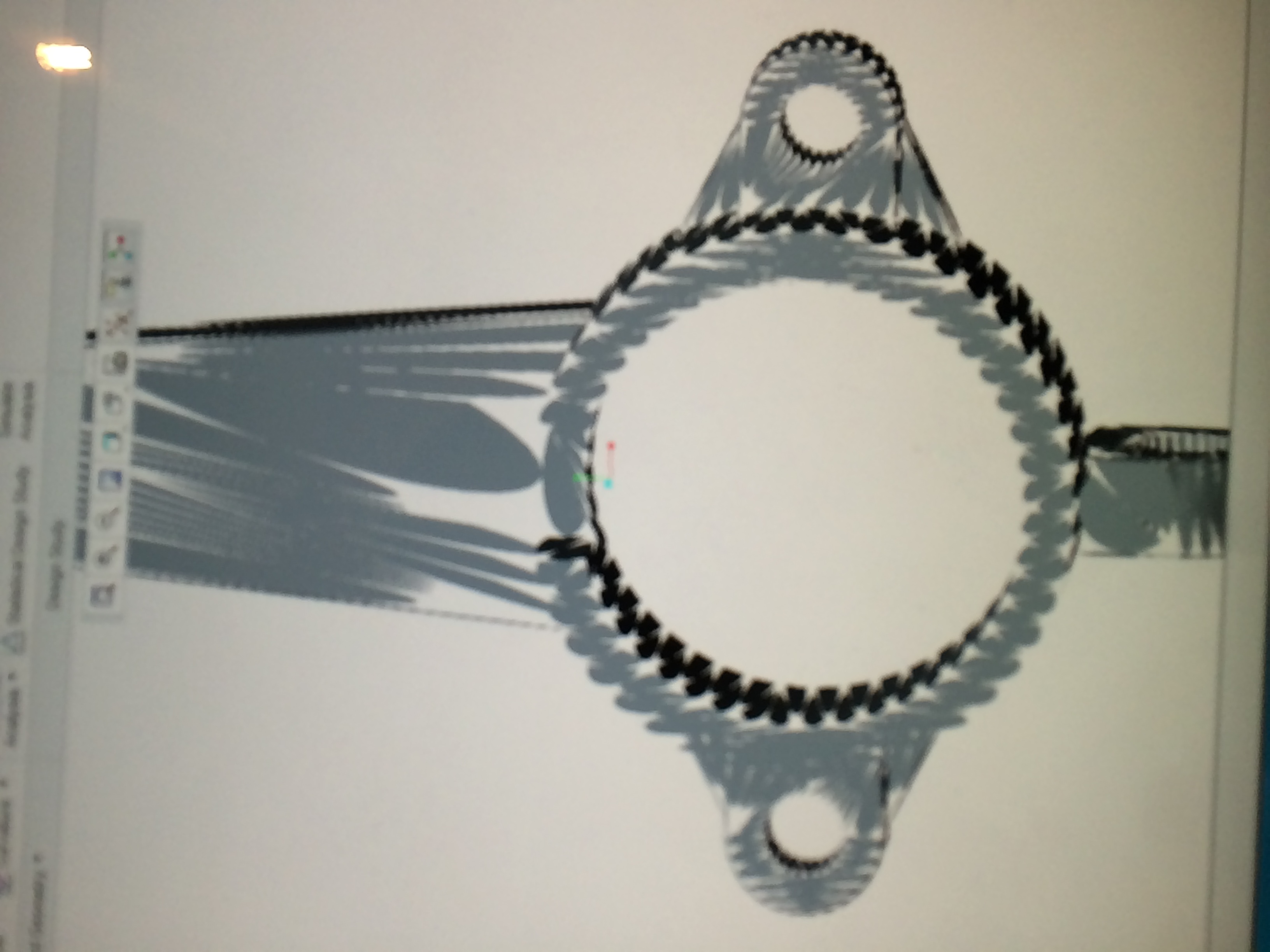

Thanks it worked. I have another problem with the graphics, when i zoom in and out there like small gaps in between the extruded item it kind makes me really itchy. please see attatchment:IMG_2859.JPG
October 31, 2015
step 1. >>> test
Add the following options at the end of config.pro file, restart Creo and zoom in and out your model.
graphics win32_gdi
step 2. >>> graphics drivers
If step 1. resolves the problem then you have to install newer graphic driver.
