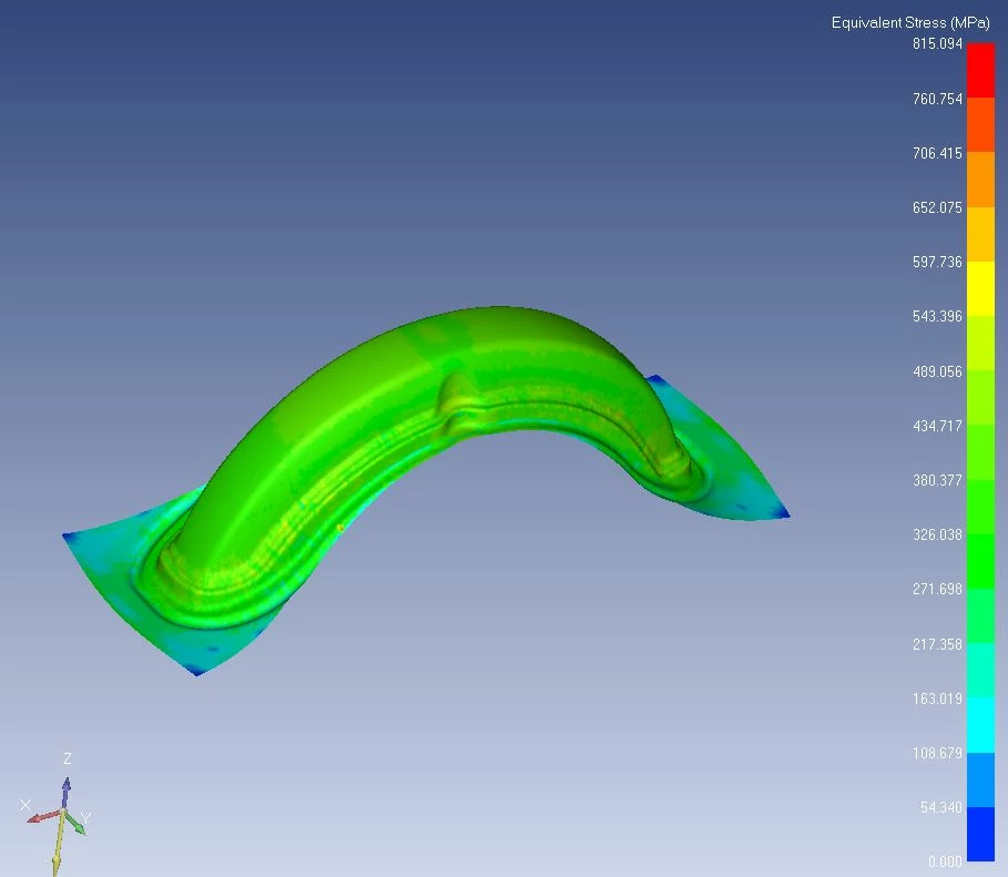

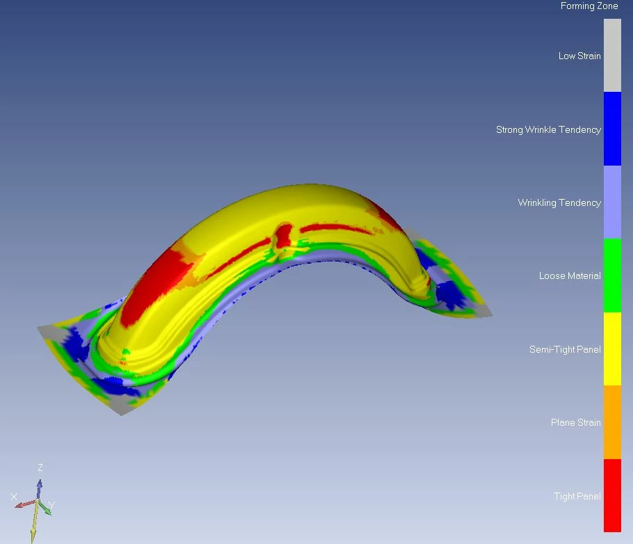

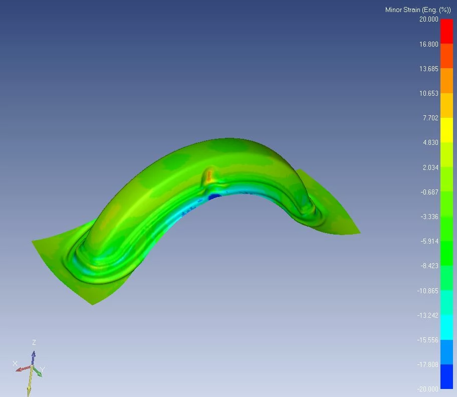

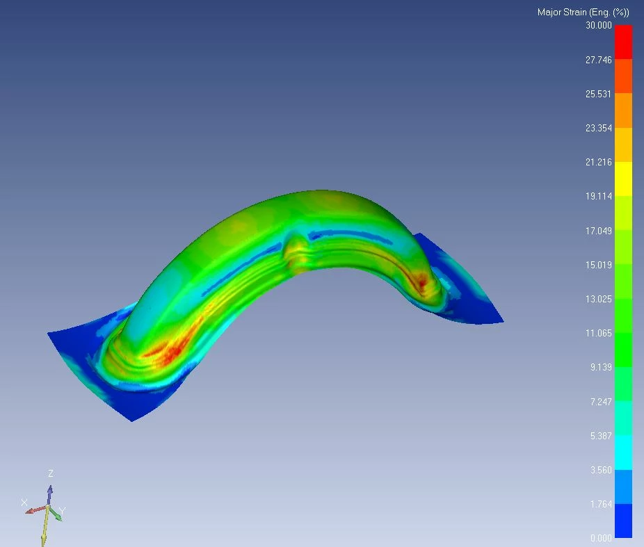

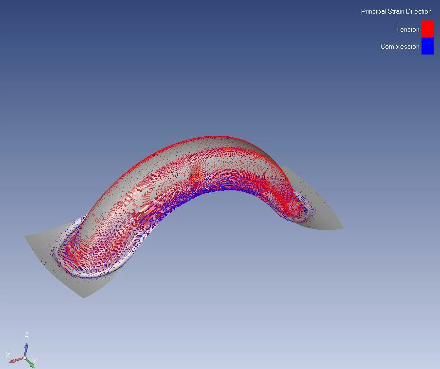

hello, this is FISA I need help to understand the deep draw simulation result I am a self-learner using the forming suite. please check the attached jpeg of my simulation result. I want to know what is the behavior of this part in real die operation on the basis of this result.
