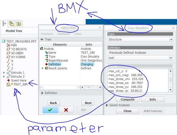

you need BMX:

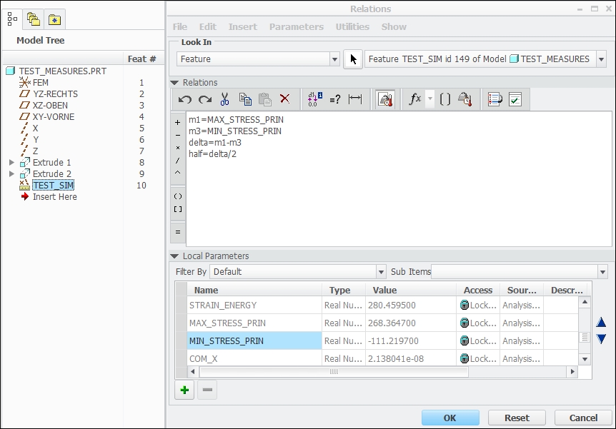

No, I'm talking about within Simulate.  It appears that I can't calculate an 'interim' variable, then use the result of that calculation to calculate another result - I have to do the whole calculation in one, complicated, expression.
Calculated measures can refer to 'simple' measures but not to other calculated measures within the same analysis, it appears.

Jonathan,
"It appears that I can't calculate an 'interim' variable..."
yes, it is not possible in simulate, but with BMX (extra licence).

February 2, 2017
Another possible limitation... it also appears that you can't reference a built-in measure in a computed measure!  This is a bit disappointing - it really limits the power of computed measures, if I can only use quantities that I've directly obtained through a 'simple' measure
February 3, 2017
Jonathan,
You have to duplicate the predefined measure with a user defined measure that does exactly the same thing.
