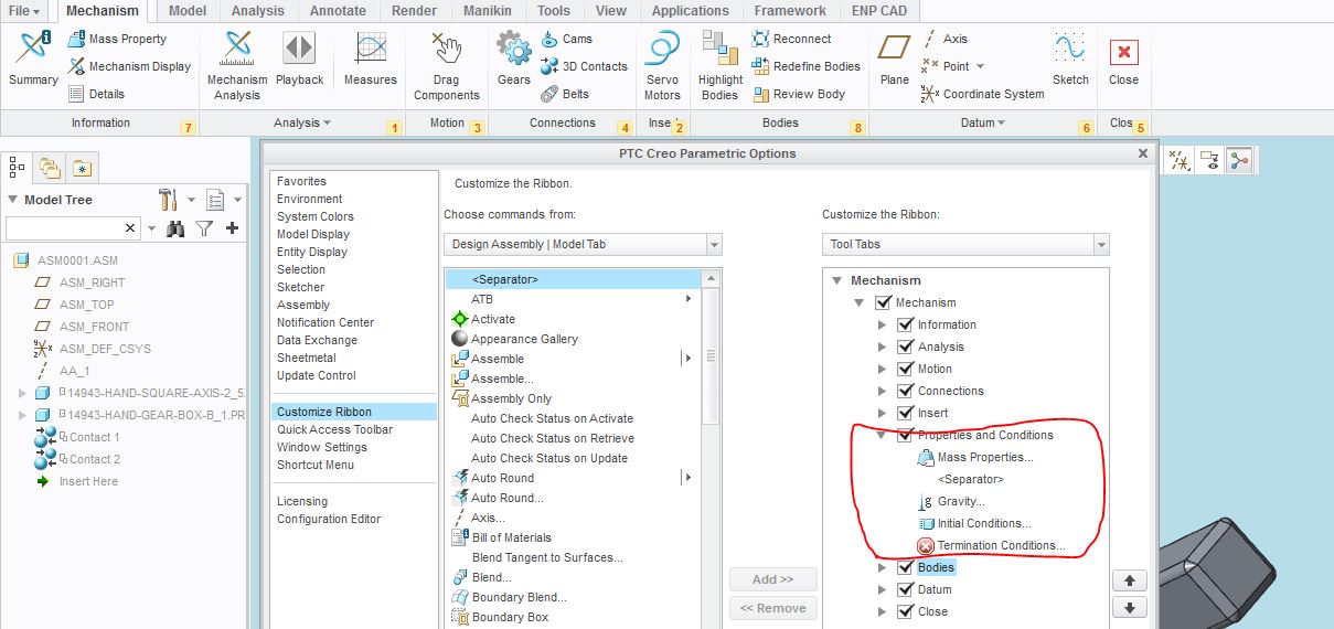

I am using Creo 3.0 to do some Mechanism work, however, There's no Properties and Conditions group on the ribbon, and it is not possible to customize the ribbon to make it appear, see below picture, have checked this group in the ribbon customize window, but still can not show it on the ribbon?  Anyone have any idea about this? Please help, thanks.

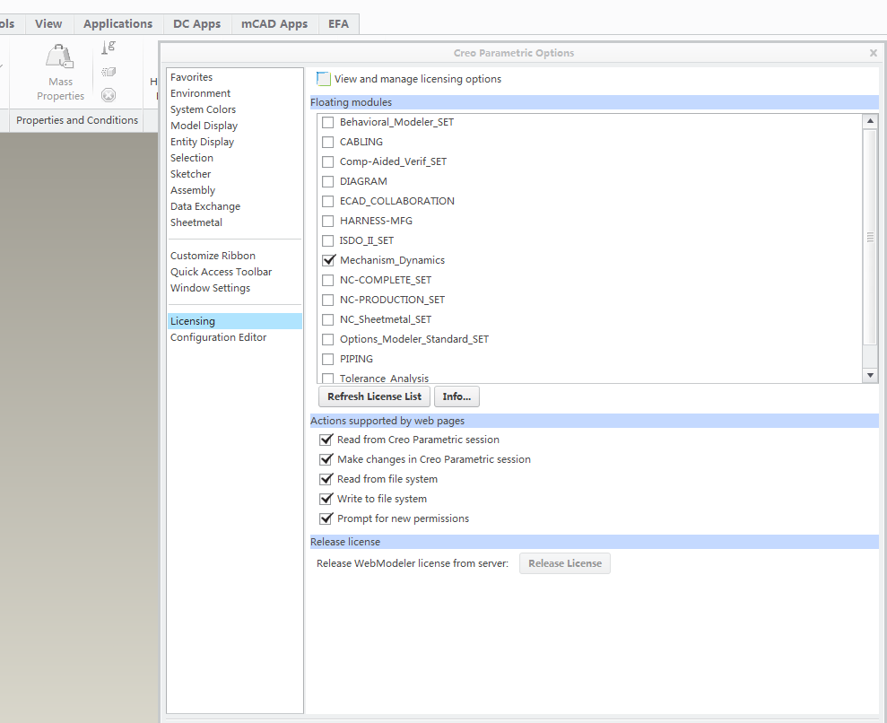

I think you didn't active mechanism dynamics license in your Creo.
click "file", then click "option", then click"licensing", you can find it. choose "mechanism dynamics"

Thank you Jason, you are correct and it helped.
Checked with our IT and it turns out that we only have mechanism design license, no Mechanism dynamics licens, so can not use this funcation.
