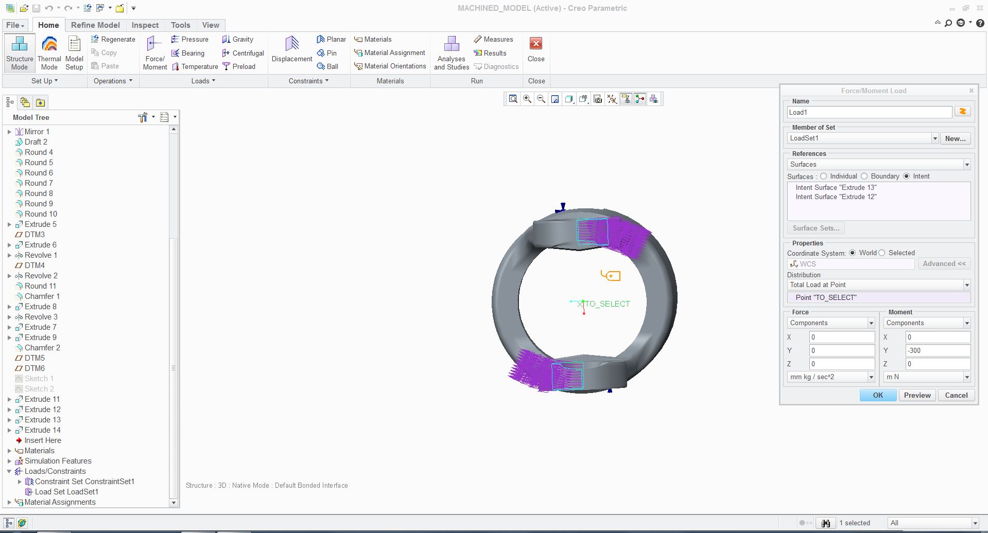

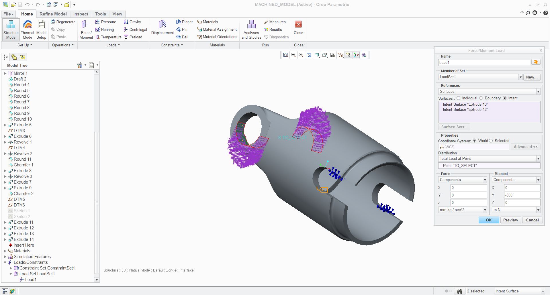

Hi all,
I think I've defind all constratints and Moment load correct, but the result values for Stress Von Mises is coming much much higher than the expected,
Expected values should come withing the range of 200-300 MPA, but its coming 4000+ MPA.
Please Help

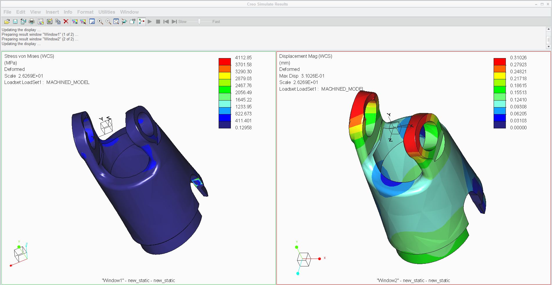

I didn't look at your attached model, but it appears to me that your results are near that approximate expected range close to the "ears" where the moment is applied. The 4000+ MPa readings are near the constraint locations. Change your legend scale and/or probe the results near the area of interest.

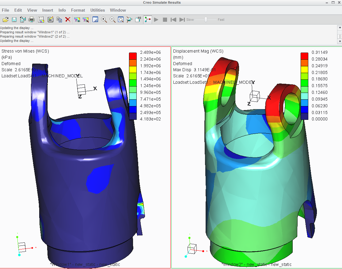

With your model, I can get the results within the range of 200-300 MPa.results.png
ssharma-21-VisitorAuthor
April 16, 2013
Hi Abhijit,
As per your screenshot, you have opted units in results as Kpa
Request you to pls check it in Mpa.
