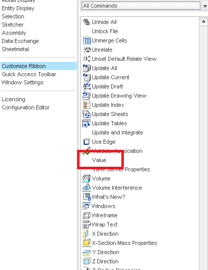

we migrated from Wildfire 4.0 to Creo 2.0 , and I still hope that one day I will find the "Edit Value" function that was present in past version. So far there 3 ways to go that I could figure:
1 - "press alt+click" the parameter if parameter is in a table
2 - be in the "table" tab to edit value if parameter is in a table
3 - click to highlight parameter, then click again but not too fast after the first click. If you click too fast it open "properties" window of that "annotation"/parameter.
All of these methods are pretty bad compared, to the single "Edit value" function that was present in the past.
Anyone knows if, "Edit Value" exist in any simplier method then the three I described ?

Value is a command 'not in the ribbon' customise your ribbon and create a Group on one of the tabs with it in there
Hopefully this will give you what you want

Hi Charlotte,
I just can't find the "value" function you refer to. I have looked at customizing the ribbon, in "All Commands" but can't find it there. Also looked at each expandable menu of the ribbon, nowhere to be found.
I have no problem customizing the ribbon, but if you could indicate me more in detail where to find the "Value" command I would appreciate.
November 5, 2013
Hi Alexandre - which version of Creo are you using?
I am on Creo2 M040, if you use the search facility does that show it up??
Then you can see where mine is on the customising ribbon
