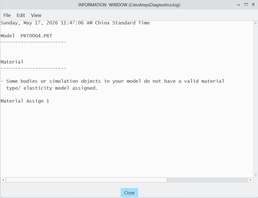

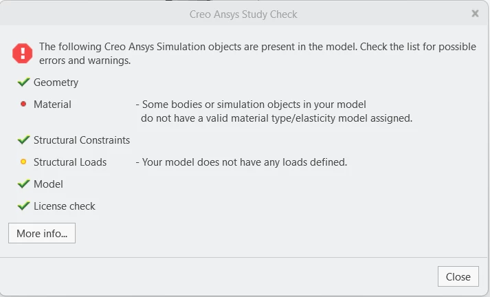

I want to simulate the O-ring contact stress under a certain displacement, when I meshing the part, it pop out the window as below.

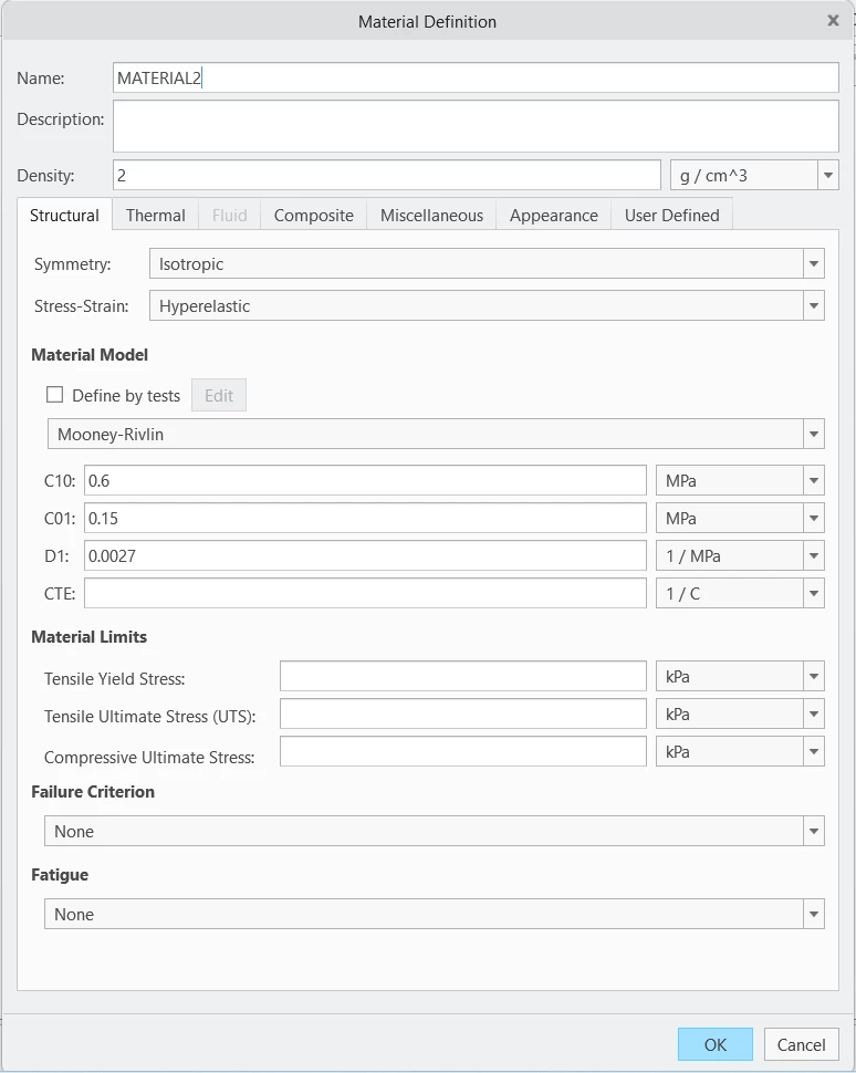

it seems that there is something wrong with material assignment. the material property is shown as below(just an example, not real case).  the Mooney-Rivlin model was used to describe the material property.
Could anyone help me check what’s wrong here?

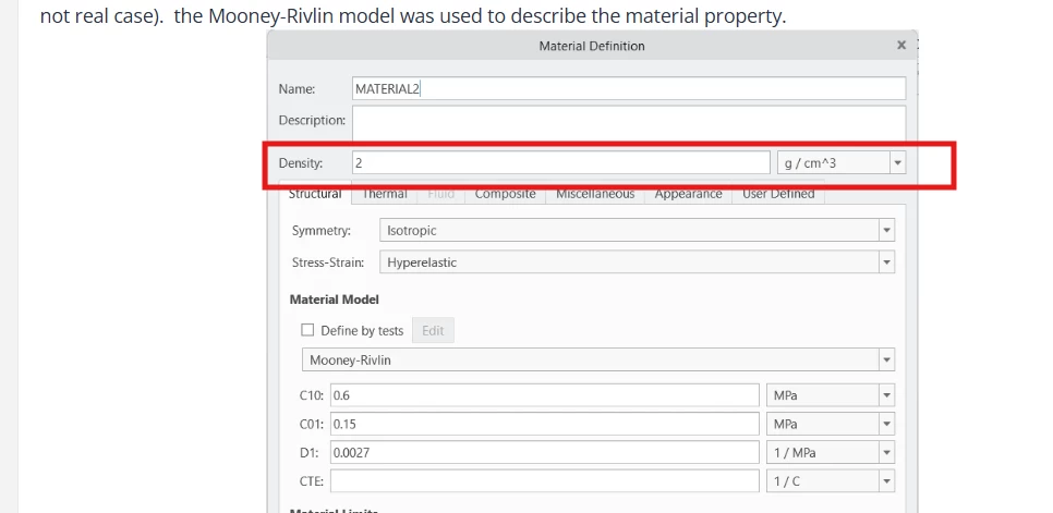

Kindly apply some realistics material values, not the random one.
May 29, 2026 3:40 AM UTC
Thanks very much for your reply. I changed the density to a reasonable value 1.2g/cm3, but same error exists.

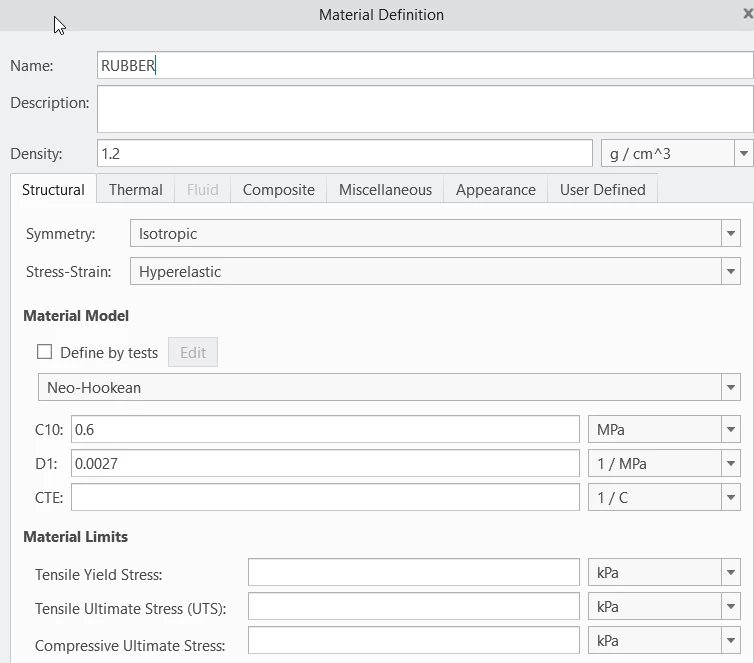

May 29, 2026 3:44 AM UTC
Additional information, if I use the Neo-Hookean model as below, it works. no issues.
