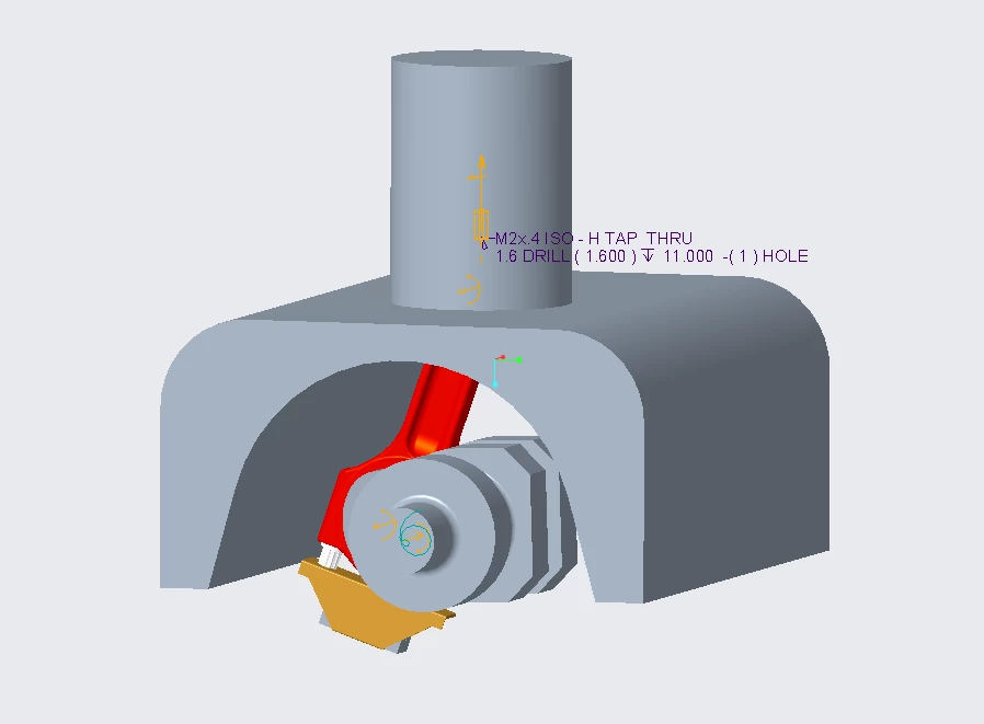

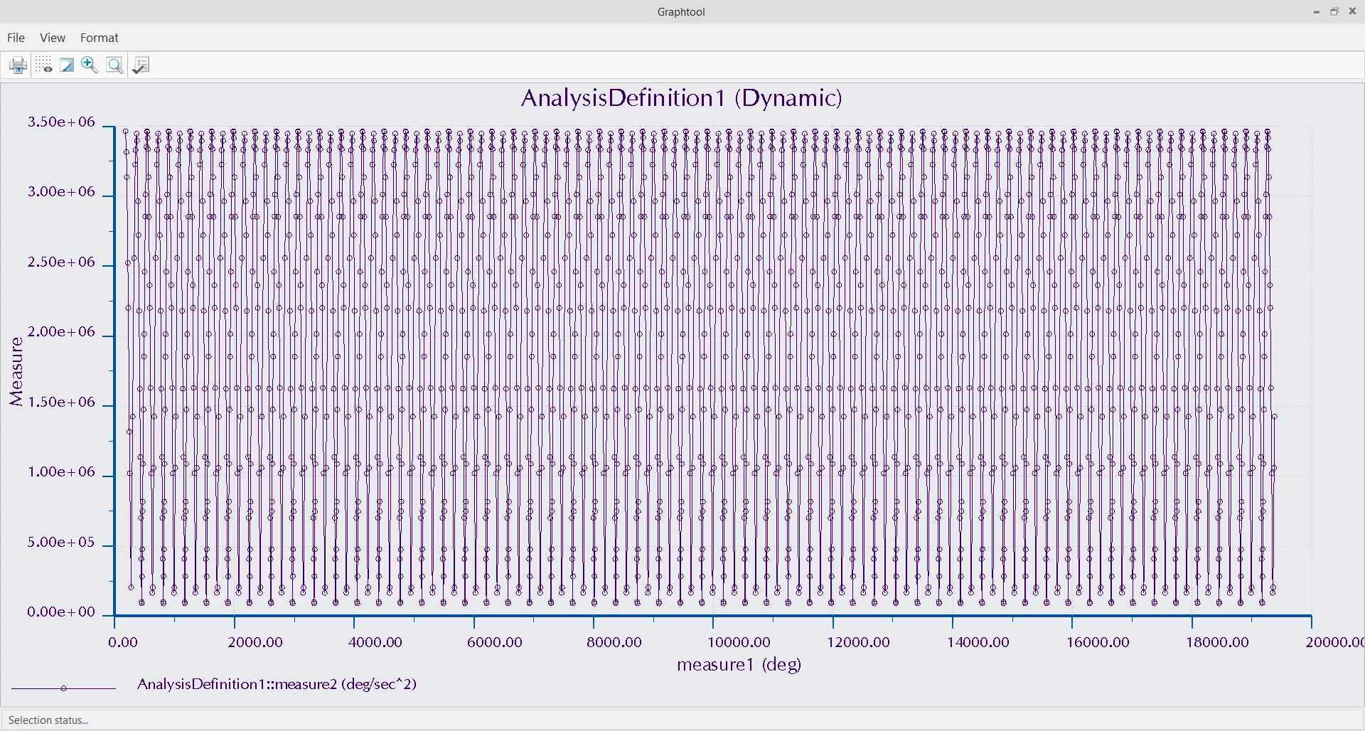

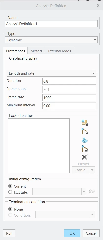

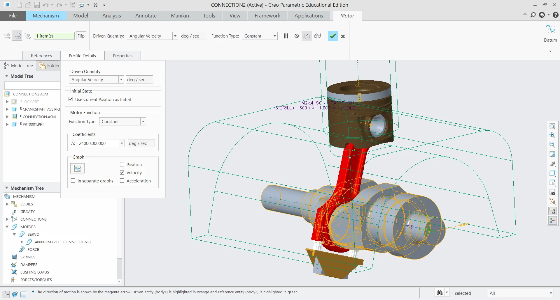

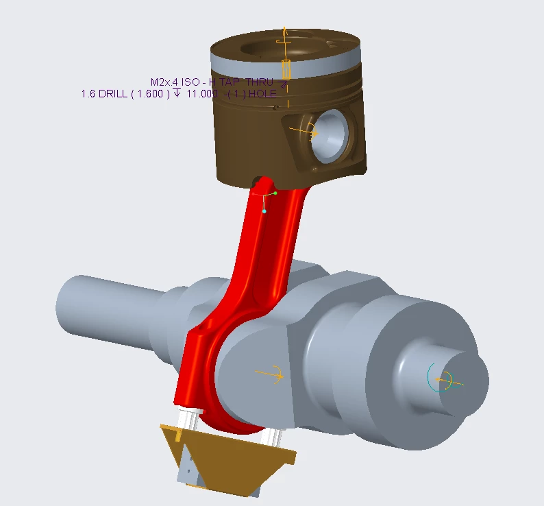

I have been working on a project of analyzing (dynamic mechanism) the angular acceleration of a piston and crankshaft mechanism. I have kept the servo motor to 24000 deg/ sec constant in angular velocity, since I need it for 4000 rpm. I ran it with desired co-ordinates and axis, but I get a varying angular acceleration which is absurd. I don't understand where I am going wrong and would be really glad if someone can help me out in this regard! I have attached the files with this thread FYI. Kindly help me people! 🙂

Sorry for the inconvenience caused. I read it's not possible to open it in a commercial version of Creo, so I'd like to attach the images since the model could not be displayed. Please look into it and help me in this regard. If you need anything else, please let me know.
