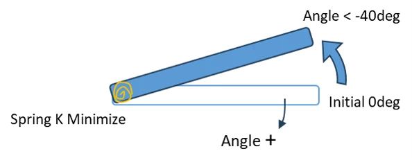

Hello. I am simulating one beam model which rotates around an axis.
・A clock spring is set on the rotation axis.
・In MDO, beam model start to rotates upward once it start running
I would like to explore Minimum Spring Constant K (Nmm/deg)  that allows the beam model to rotate more than 40 degrees.
(no need to change Beam model dimension)
In this case, is it possible to obtain a solution for the spring constant K with BMX?
Or any other solution in Creo?
I try setting Spring constant K as BMX Goal by using relation. But it was not explored
This problem will be solved by hand calculations. However If a solution exists for this simple problem, I will apply the method to more complex problems . (to simulate Car Seat Tumble Motion)
Any advice would be greatly appreciated.

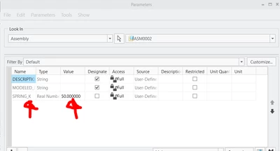

STEP 1:

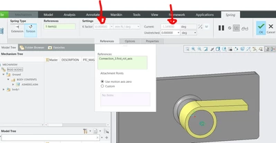

Create a parameter called SPRING_K and assign it a random value
STEP 2:
Create Torsion spring and assign parameter created to K factor i.e #SPRING_K

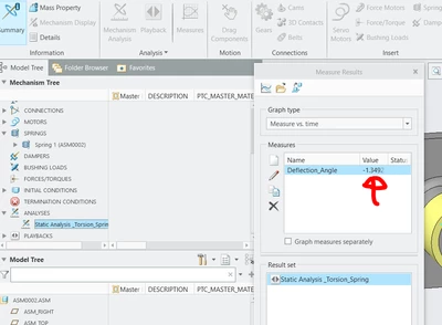

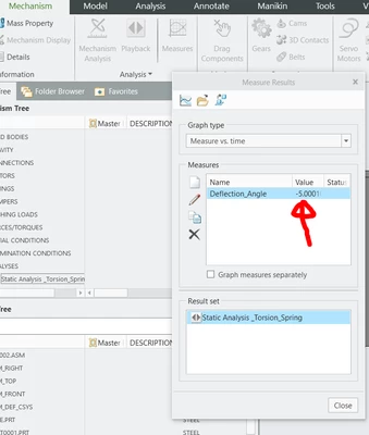

STEP 3 :Create a measure of twist angle  and run static analysis ensuring gravity is enabled and material properties assigned to the part
I will use BMX to determine K value which  will make twist angle to be -5 degrees (your case might be -40 or 40)

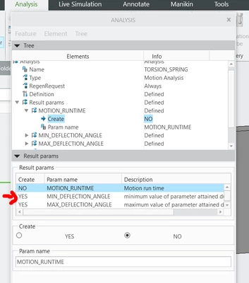

STEP 4:

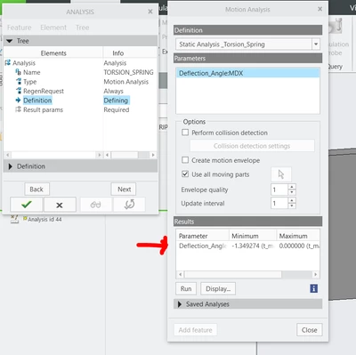

Save mechanism and playbacks , open Analysis and create motion analysis. Create parameters . you should get MIN and MX parameters of mechanism measures

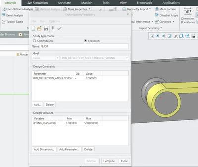

STEP 5 : Run feasibility analysis (you might need sensitivity analysis depending on complexity of the design). Add Your constraint (mine is -5 degrees) and Variable SPRING_K parameter (The one we used in the mechanism)

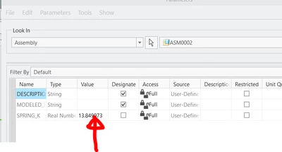

Results: Analysis will change the parameter until your goal is met

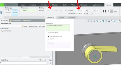

Validate Results by running Mechanism again:
