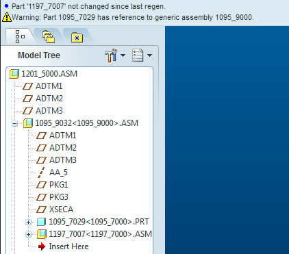

I am getting the following error:
I am looking for a way to diagnose this reference and fix it.
The warning comes up for several instances within this family (1095_7000) of parts.
Thanks, Dale

Did you go through some process of renaming a generic from 1095_9000 to something else?
I've had tis happened where it gets references stuck from time to time.
I think the fix is deleting the familty table index files from your working folder.

Is that the .tst file?
Thanks, Dale

There is an article on web (CS35910), I think this may give you some information.
January 23, 2015
https://support.ptc.com/appserver/cs/view/solution.jsp?n=CS35910
Yes, the .tst are familty table indexes. The CS article does explain better why this happens. Kinda scary.
