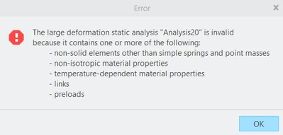

I am getting the below error when I am trying to use non linear option
skunks
Jun 2, 2023 12:22 PM UTC
yes, large deformation analysis is non-linear.
some non-linear options cannot be combined
