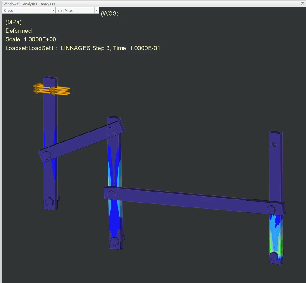

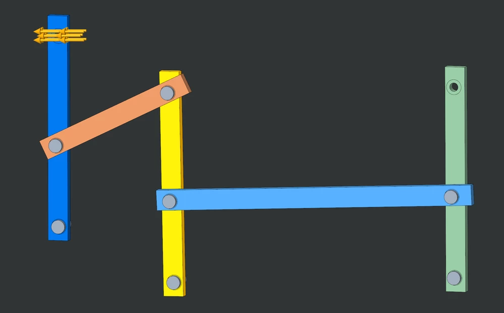

sort of like this maybe? ModelModel
StressStress
Pin model interfacesPin model interfaces
Is it possible your pins or links are under-constrained and free in axial translation?  My pin is bonded to one of the link elements and the 2nd link element is sandwiched by contacts to arrest translation, in addition to the cylindrical contact.  I made disc shaped surface regions at all the pins to accomplish this.
Are there bending stresses at the bottom of your 2nd lever, more like the remote lever in my result?  This would mean it is somehow not free to rotate.
Since for contact you must have NonLinear /use load histories, how many output steps did you ask for?  It is possible, if there is large amplification of movement due to the lever system, that the contacts move past each other too fast to be resolved, so smaller time steps, larger elements near the contacts, and/or larger penetration depth may help as well.
My model is simple enough the elements are relatively large, and I have contact penetration depth set to 15%.  My model does not have excessive mechanical advantage/disadvantage.  I set my output steps to 21 - user defined - space equally.
I also recommend setting up a simplified model to prove it out before swapping more complex link/lever geometry.
I have this model in Creo 6 and can send it if you can use it.  Hopefully I have given you some ideas to pursue.
