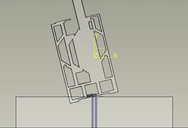

Hello All,
 I am trying to simulate effect of wind load on glass railing holder which is fitted to ground via. screws. so after defining the constraints , contacts and loads when I review the results I observe that the glass holder penetrates into the ground. see attached screenshot.
Can you please advise why is it so and how can it be resolved? I would appreciate your help with it.

Please upload STEP data.

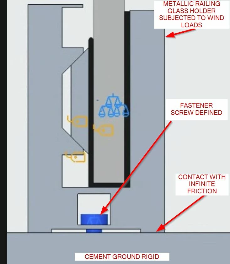

What is the second picture of exactly? Is that the displacement result? If so what is your scaling factor?
You say that the railing has "contact" with the cement. Exactly what constraint are you applying there?
How is the "fastener" being defined? Is that a solid model? Is that a Simulate fastener? Spring or beam element?

1. Scaling factor is 10% see page 13
2. I have defined contact interface between railing and cement: see page 10
3. Fastener is a simulate fastener: See page 11

Some comments:
1. Your loads are in metric, but your last slide is in psi which is confusing. The last slide that shows the deformation is not in units of length so its impossible to tell how much its actually deforming.
2. Not sure if your UDL includes the 1G weight of the structure, but if not you might want to consider that load.
3. Fasteners are not good at carrying moments by themselves. If you look at other railing designs they usually have a 4 bolt pattern so that when moments are applied the fasteners go into tension. A quick hand calc with a moment applied to a single fastener will demonstrate this for you.
