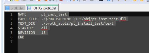

If you have no buttons at all and you don't have the configuration menu (Tools tab-->Toolkit-->Tools-->3Dconnexion) then it sounds like your protk.dat file may have either been overwritten or your config.pro isn't pointing to the correct protk file or path.
Protk tells Creo where to load the SPP files from so that would make sense if you don't have any buttons/menus. Locate your protk.dat file, open it and verify that there are entries for your SPP (about 3 lines or so), then make sure your config.pro points to the file or else leave the protk file in your start directory.
If you are missing the SPP entries in the protk file, there are example protk files in the 3Dconnexion folders for your operating system and version of Creo/ProE. If your company has custom programs that they run from Protk, make sure you add the SPP entries into the file and don't overwrite the file.
January 15, 2014

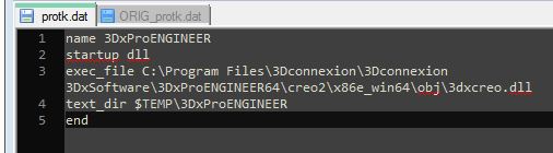

That was it!
It's the protk.dat file that has been overwritten by the update M090.
What I found in the M090 protk file was this:
I added the command line as you suggested and it failed.
I deleted the original text command sequence shown above and saved this:
I also changed the path in my config.pro.
It now works as it should, all menus buttons and the motion control is noticably better after the Nvidia driver update.
When I first had problems, I thought about the protk and dismissed it.. simply because I didn't have to do anything with it when I installed all of the design programs.. it just worked with the SPP/ CAD programs (and previous updates) working together to make the right connections.
Many thanks for the help Eric T, and I will forward the info to PTC support to close the case.
