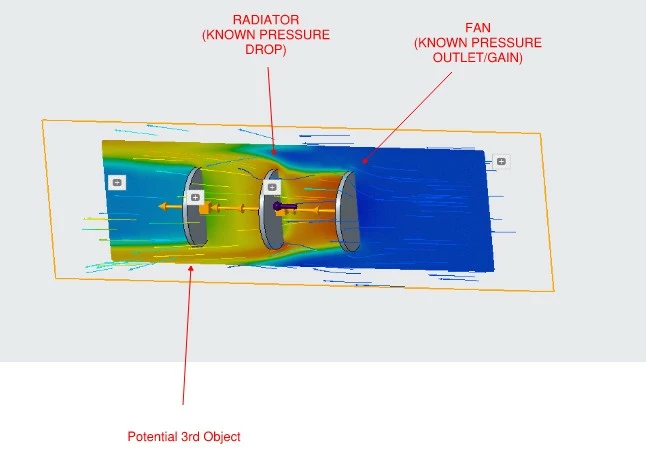

I am trying to set up a CFD analysis where a fan is blowing air through a radiator. I don't know the exact geometry of either the fan or the radiator but I know the general size and I have charts to tell me how much pressure drop to expect on the radiator and pressure gain from the fan.
Can anyone help to tell me how to set that up in Live Simulation? See the attached picture as a reference.
I have tried to enter a positive pressure on the outlet side of the fan and then measuring (with a probe) the pressure on the surface of the radiator in front of it.
Then I take that measured pressure value on the incoming side of the radiator and enter it as inlet pressure. Since in know the pressure drop from the chart, I enter a lesser value on the outlet side mimicking a pressure drop.
Am I on the right track or is there a better way to set that up?
Thanks!
