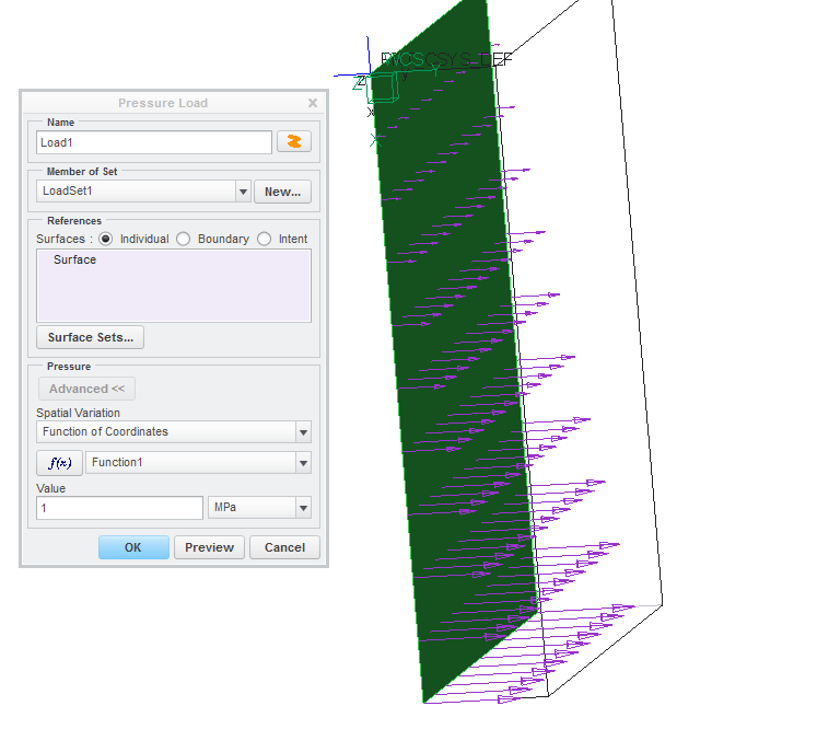

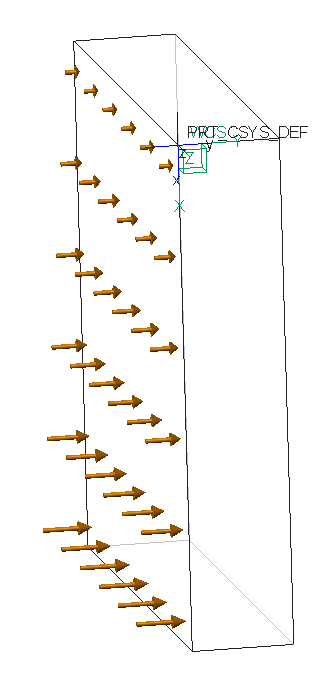

I think it does, if you click "preview" in your pressure load definition form. You might have to look into your simulation display settings...
And after having exited the load definition dialog:
