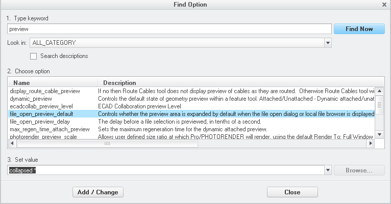

I use Creo 2.0; when I open a file in the open file window appear the preview area.
This happens automatically, also if the function in the config.pro file is disabled.
I kindly ask how to proceed to definitively disable this functionality.

You have this setting set to collapsed and its still always showing the preview?

Yes, it's so. Setting set to collapsed and preview area opened.

Is Creo opening using the desired config.pro file with the correct setting? If so this may work like the graphics toolbar, you may have to close the preview window manually and then save your config.pro setting, before it will take affect.

Confirm that file_open_preview_default = collapsed is not being overwritten by another config.pro file of greater priority. You can verify this by selecting "current session" from the Display Filters dropdown in the Configuration Editor. If the option is still set to "collapsed" in the options list then I would advise you to open a technical support case with PTC as James suggested.

I verified settings of current section (menu File - Options - Configuration Editor) and file_open_preview_default is always set as collapsed.
I think I'll open a ticket with PTC.
