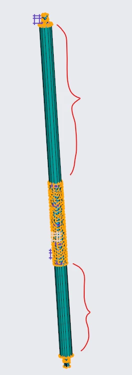

Hi folks,
I'm wondering if it's possible manage elements that era created using the "Prismatic Elements" control.
It doesn't feel the other control on the geometry like "Maximum element size" or also the general Mesh setting as Max aspect ratio.
If you see the attached pic, where I've marked the two red brackets, I can't set the Wedge depth.

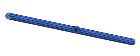

At the moment I work around this issue with the addiction of much volume regions (second pic attached).

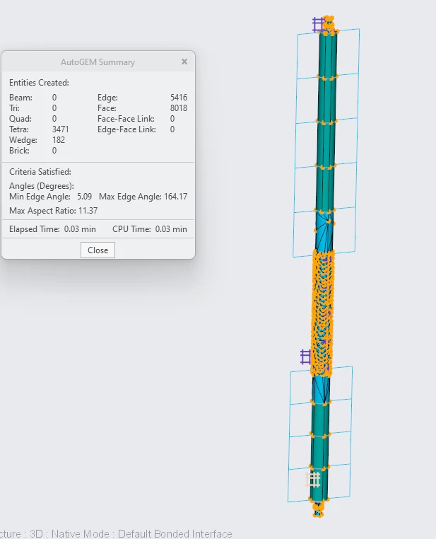

If I model like you, Simulate has some restrictions, like in the following picture:

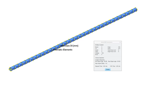

I haven't used this control so far either, but have tried manual nets, as in the example here.
skunks
Jan 28, 2025 7:15 AM UTC
mesh:
